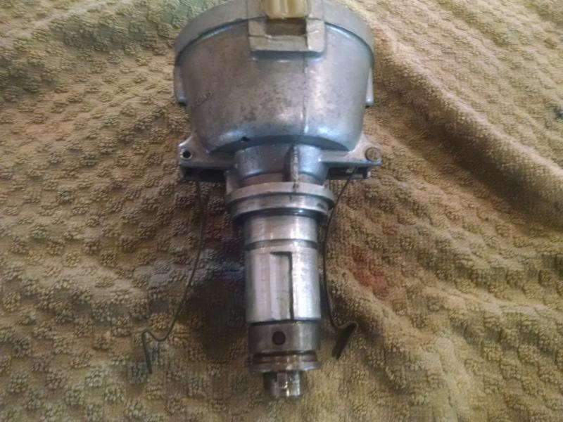

Soooo. I bought this basket case about 5 years ago. It's progressed in spurts as inspiration has inspired me. Mechanicals are complete back to front. The engine is rebuilt, spins nicely under battery. Has good Oil psi. Carbs are gorgeous. I'm really close to letting it see gas except.... The distributer that came with this project, 1. has a keyway as if it's supposed to engage something when slid into the engine. But no corresponding key in the opening. AND 2. I've got no vacuum advance on this thing. It doesn't seem to match anything that Moss or my manual show. Thoughts??
I should add. It's suppose to be a 64 sprite. Engine is the 1275

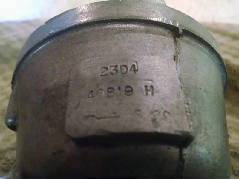

The Mini Cooper-S ran a 23D distributor which did not have a vacuum advance. Look for a 5 digit number beginning with "4" stamped on the distributor housing. The Cooper-S dizzy would be 40819.
If the distributor was not installed in the engine when you got it, the drive gear may be missing. The drive gear would have a slot to accept the drive dog on the bottom of the distributor.

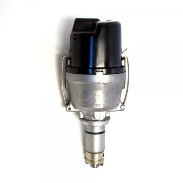

The image below is the 23D distributor. If you open it in a new window and look at the bottom end you can see the drive dog. That goes into the drive gear.
EDIT: I should have mentioned, you can run the Cooper-S distributor in your 1275. A lot of people have done that... including apparently the previous owner of your car.

Wow. I love this forum and all the intelligent / experienced folks. You nailed it. I believe my drive is good. What had me confused or concerned was the keyway cut into the side.
Thank you. Now I have to decide.. Do I try and start it (for the first time in 16 years I am told) or go fishing. It is a really nice spring day here in Western NY
