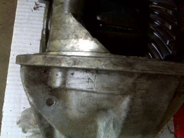

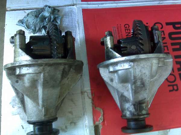

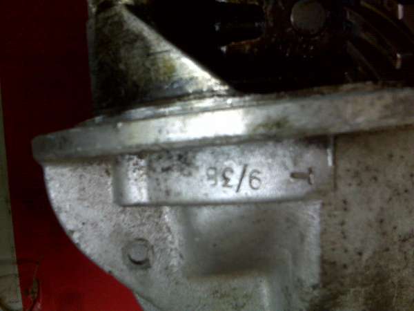

Well, it took about 3 hours in 97 degree temps but the swap is a done deal.
I like the 4.2 a lot better. Now I have to watch out for accidental wheelspin. :driving: Pulls the driveway with no clutch feathering.
5200 rpm at 65mph.
Speedo is still a tad slow according to GPS but I can live with 3 mph slow indication at 60.
I know my 0-60 is significantly improved.
Both diffs had numbers stamped on the top of the hogshead.
If needs change it's good to know the 3.7 is stored...just in case. :jester:

The 9/38 is the fraction for a 4.22.

I found the mark on mine, it appears to be 9/38, so I would assume it's the 4:22 original... until I open it up and check the gears.
