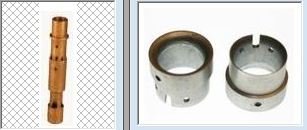

the parts I'm talking about

F16 tubes and 30 chokes. 14 @ idle 32 full. Thought it might be that carb and put another one on and the same thing. Swithed to a 170 air correction w/ no change. Swapped to a F9 tube w/ no change. Both carbs are shooting fuel strong out the pump jets, maybe too strong. I'm wondering if it's a design flaw w/ the 1500 single DCOE intake as it would appear that maybe it's just shooting straint down the throat of 2 and three and 1 and 4 might be too lean and stumpbling. IIRC, I read somewhere that these manifolds do that.
