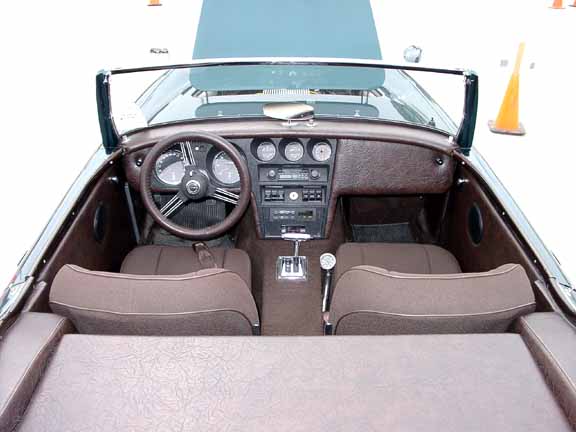

So, rather that list all the things I am doing I'll just ask the first question of you guys. Has anyone made seats for their car? I have seats with almost new trimming - they are 'fine'. But they are also terribly uncomfortable to tour in. No lumbar support at all. I could try to modify them, but think I will have a go at making some from scratch. I plan on using a steel tube outer frame and then fibreglass the rest, and use the existing seat rails/adjusters. Essentially I'll use the Healey design, but making them slightly higher in the back, lower in the seat pan, with lumbar support and more side wrap-around/bolstering.
Any thoughts or comments?
