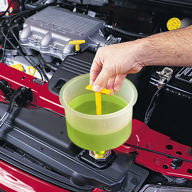

I found the Lisle Spill Free Funnel to be very handy for filling the cooling system without the need for ramps etc: https://www.lislecorp.com/specialty-tools/spill-free-funnel-606
it comes with an adapter cap that fits on our radiators, and you fill the funnel well above the thermostat level, open the heater valve and run the car at idle until the thermostat opens and all of the air is expelled from the system. Turn the engine off and after it has cooled then remove the funnel with the yellow stopper and you are done. Pour the excess back into the antifreeze jug.
The downside is that it is a bit pricey for a funnel, but it does the job, and quickly too. There are several You-tube videos that show how you can make your own.

Thanks to Andy above for showing the coolant funnel with stopper - I hadn't been aware of those. Bought one on Amazon (different brand) and used it. Worked like a charm! Just had the radiator serviced for a leak, also installing a 1/8" NPT bung in the top tank for the electric fan thermo switch and a 1/4" NPT bung in the bottom for a drain tap. I had run Thermocure for a couple of weeks to clear out the rust and am going to run this Tefba filter for a while to capture any loose rust bits.
When I removed the funnel, given the radiator cap is lower than the thermostat, not sure why no coolant overflowed the radiator.
Nice being able to fill the system without undoing the thermostat cover.
