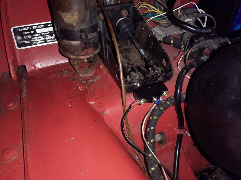

Thought I'd give you an update. I have done the gearbox swap - twice! The original came out sweet as a nut, getting the new box in was a pig, but once we had everything lined up it slid in and we could bolt it all up. I found a very useful garage tool in the process, a slim 21 year old son who can slide under the car and wiggle the bellhousing :smile:
Once everything was in place and I'd wired up the overdrive it was time to test it. First depression of the clutch caused an almighty grinding, clearly the release bearing. So, it all had to be disassembled again. the release bearing was rubbish - found out since there was a faulty batch, my supplier has 10 on the shelf, all with the same manufacturing fault, and no, it wasn't a cheap Chinese job.
So, all put back together, cursing the gearbox to exhaust mount and my fat fingers for a second time. This time it all worked. The first swap took three evenings, the second time about 4 hours!
In the process, removing the starter motor, we broke one of the tangs from the brake light switch:rolleye: As I'm up against time (and accessing it means taking the exhaust off again....) I offer you bodge of the week, which is actually very solid and may remain for some time........

Graham H
That slim 21 year old is the right accessory to fit a TR gearbox, a job you only want to do once?
Graham
Geo Hahn
...we broke one of the tangs from the brake light switch:rolleye: As I'm up against time (and accessing it means taking the exhaust off again....
A mechanical brake lamp switch is a reasonable alternative for reliability but... I have always been able to easily access the pressure switch by removing the right front road wheel - then it is right there in front of you. But perhaps RHD cars differ in this regard.
DavidApp
Like the bodge. May have to do something similar if my pressure switch does not work.
