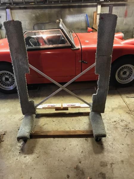

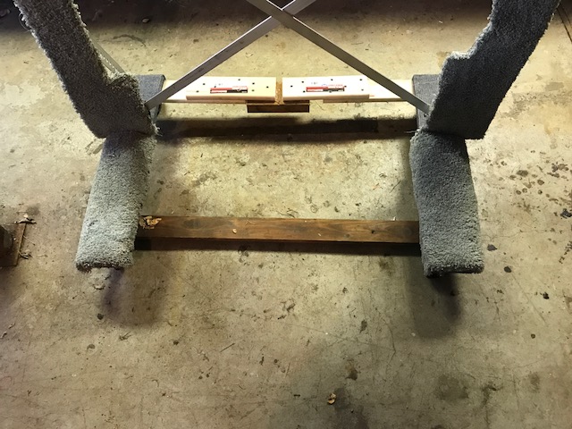

I built a frame that slides under the bonnet while it is raised up, front hinged setup, using two Harbor Freight furniture dollies, 2 pieces of Al angle, 2 pieces of Al flat, some scrap wood, and some left over carpeting.
I guess the total cost was less than $50.
The frame slides under the bonnet and then then you remove the hinge bolts. The bonnet can then be rolled around the shop.
In my case I needed to make some repairs on the radiator inlet framework which is also the main support for the front hinge system.
It only took 30 min to reinstall the bonnet on the car, mainly due to remembering how the bolts went.
