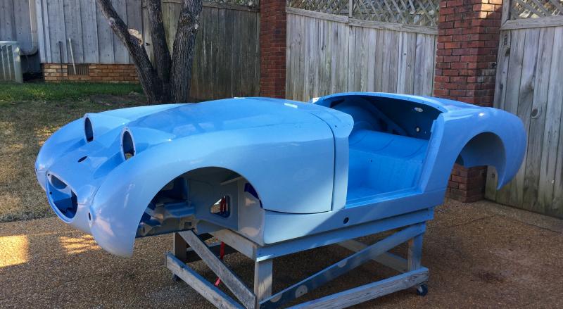

We've got a completely stripped bug-eye body tub sitting on stands in the garage and I went out and stood on a scale and lifted the left rear fender (92 pounds) and put the scale under the front (40 pounds) and came up with a weight of about 220 pounds for the entire body (sans nose, sans everything).
Not precise, but hopefully accurate enough in case anyone has been lying awake at night, wondering about such major issues.
Sounds about right. I know four old guys can carry one without straining.

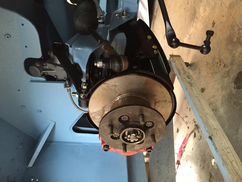

I've got mine on a rolling stand with the front and rear suspension installed and I'm wondering about the best way to lift it off. Once the plumbing and tank are installed along with the tires I'm hoping 4 old guys can pick it up! I'm guessing it will be about 500 lbs by then...
Rut

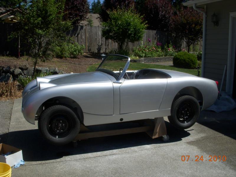

Rut you've added significant weight here. Thinking engine hoist up front and perhaps an 8' 4x4 somehow attached to rear axle going to a hoist up overhead. Rear end and front suspension have upped the weight again to over 500 lbs. if you are putting on wheels and tires that brings it up to 600'pounds. I worry if you are trying to place on jackstands it's possible for you to slip and knock one over and then have things come crashing down and get someone hurt. Some sort of spreader bar in the rear is needed so hoist ropes don't rub against the body.
