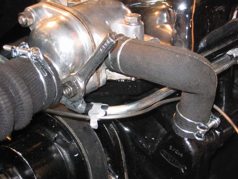

The thermostat housing was even more entertaining :
Don Elliott
When I did the restoration of my 1958 TR3A, starting in 1987, my thermostat housing looked just like yours inside. I scraped out all of this stuff and cleaned it up. It's been back on the engine for 18 years and 100,000 miles without this happening again. Maybe it's because I use a mix of water and antifreeze. But I have a brass plug threaded into the bypass pipe with a 3/16" diameter hole to allow air bubbles to vent out. Well about 5 years ago, I took off the 13 year old hose for a new one and found similar beige looking "crud" blocking that little hole in the bypass plug. Check out yours next time.
