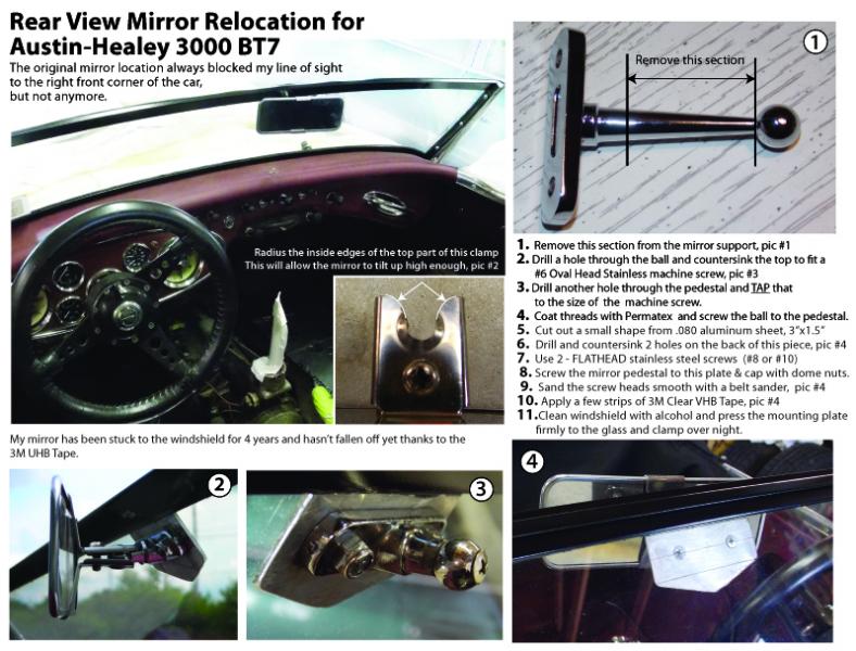

I just bought one of these adjustable ones that mount in the original location.
