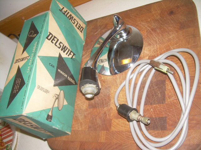

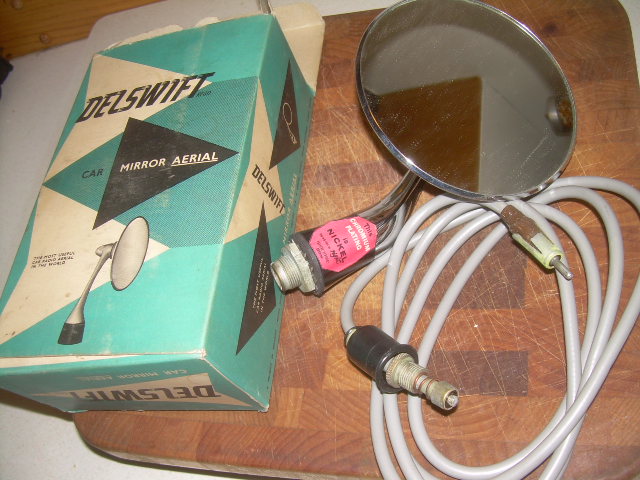

I seem to recall that someone made a mirror with a built-in antenna back in the day. I've seen them on eBay from time to time.

By-the-way, I have one of those mirror/antenna's new-in-box if anyone wants/needs one.

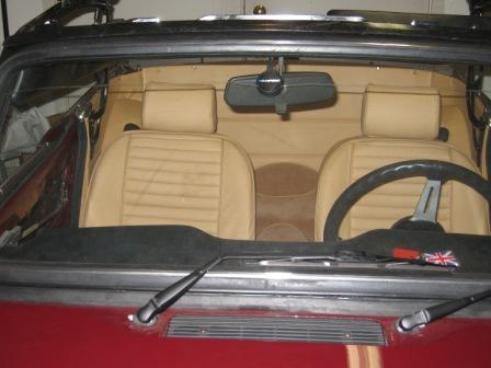

I too did not want to drill a hole in my freshly painted TR6.
I ended up buying a Blaupunkt amplified antenna. It mounts in front of the mirror and there is a thin wire that attaches to the inside of the glass....

Here are some shots of that mirror/antenna combo.
Bill
If anyone wants it it is $75.00 plus shipping
