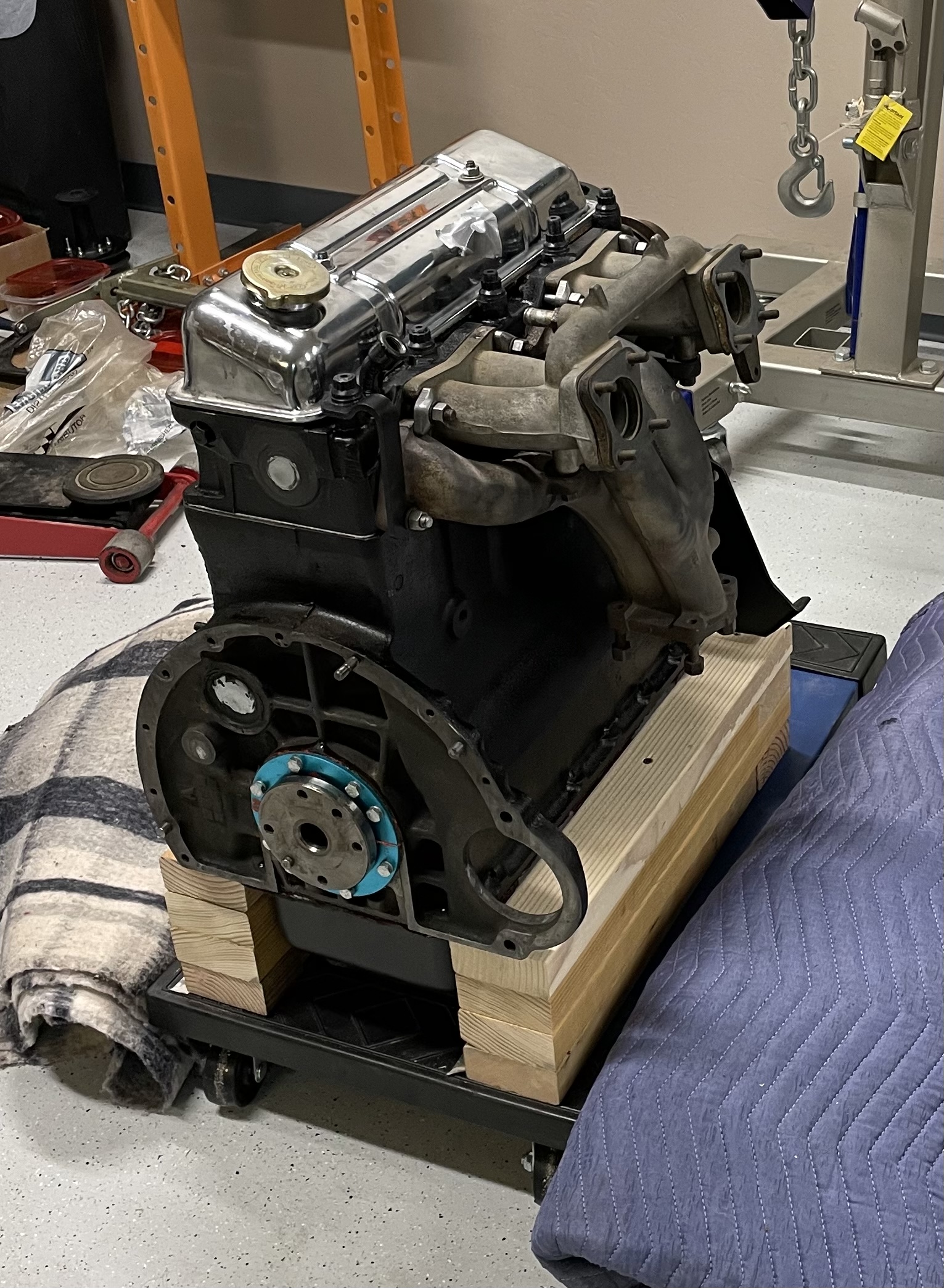

Just following up. I built that wooden engine “dolly,” and it works great. I even chiseled out a groove for the oil plug pan “swell” or protrusion where the oil plug goes— just for the protrusion, not for the plug, itself. That would’ve caused the dolly to be excessively wide.
The front engine side is also boxed in. Only the rear is open, left for transmission attachment, of course. The engine is sitting firmly on the oil pan bolts on three sides.
The dolly sits on a harbor freight 1000 pound rated dolly that was a little bit bigger than the wooden ones that I already had. There’s a crossmember underneath the dolly, sitting about a half inch below the oil pan, and screwed into the two sides for extra support.
Thanks to all who helped me here.
I am now wrestling with another issue. The flywheel bolts I purchased are too long. I’ll deal with that in a separate post.

I like the dolly a lot. The good news on catching the bolts now is they could have been like 1/32 too long and you might have thought you had it torque down, but did not.

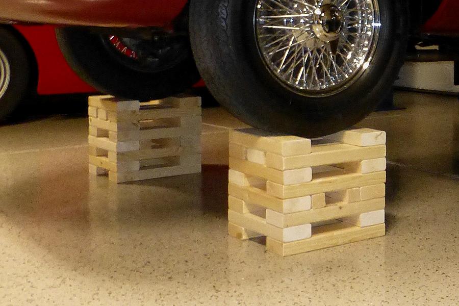

Plain screws or nails. There is not much shear load on the fasteners when supporting a vehicle. (Do not be tempted to add casters to the bottom… would be dangerous.)
