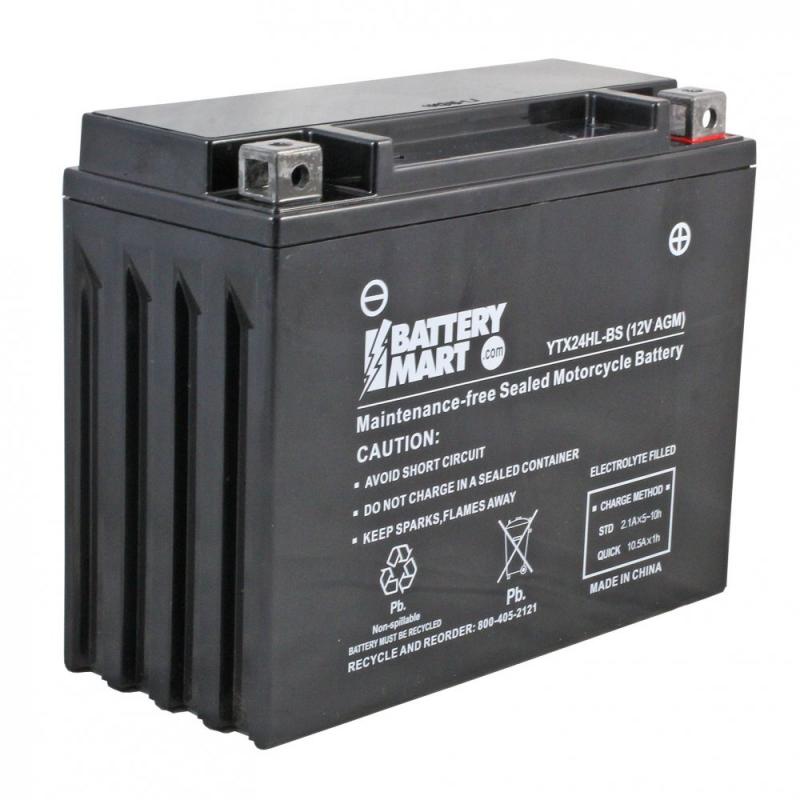

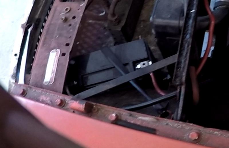

I got tired of the battery and the mess in the trunk of my 1974 MGB. Kind of a pain behind the seat too. I decided to give this AGM battery out of my 1984 Goldwing motorcycle a try. 350cca 21ah battery, it starts very well. So far I am very pleased with the results. I glued a rubber pad behind and underneath the battery and secure it with a heavy duty rubber tarp strap.It doesn't move. Plenty of room and easy to get to. Only time will tell if it will last. YTX24HL-BS-BatteryMart_side_1000x1000.jpgAGM motorcycle battery.jpg

I'll be interested to hear how it fares over the long haul. Don't imagine that it weighs much, either.

18 pounds. I understand a lot of people use Miata batteries. This one is close to the same specs. The old Goldwing is a four cylinder 1200cc boxer engine. This battery spins my MG engine over as fast as a larger battery and my car starts quick. I don't feel like it's loading the battery very hard. As I said though, only time will tell. I have had a lot better luck with the AGM battery as opposed to a flooded acid battery lasting much longer in the bike.

I'll be interested to learn how well that works out, too. I have scant space in the same location as yours is placed (air horns and compressor, extra relays installed) but it should fit in the original position.

Welcome! I have the Miata battery in my B, it's worked great for years. Definitely interested in how this one works for you.

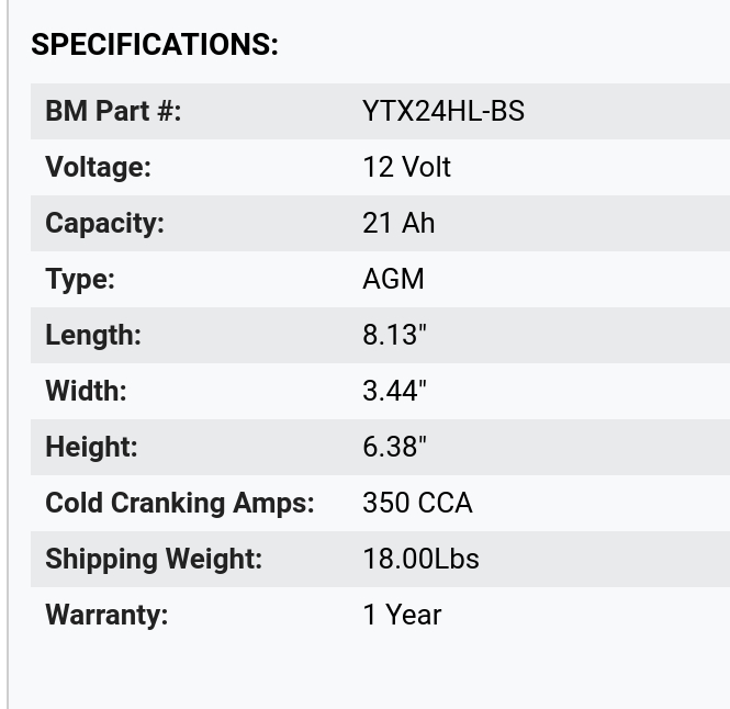

Here are the specs on this battery. The old Goldwing is down for now and I needed a battery for the MG. I thought "Why not try it".specs.jpg

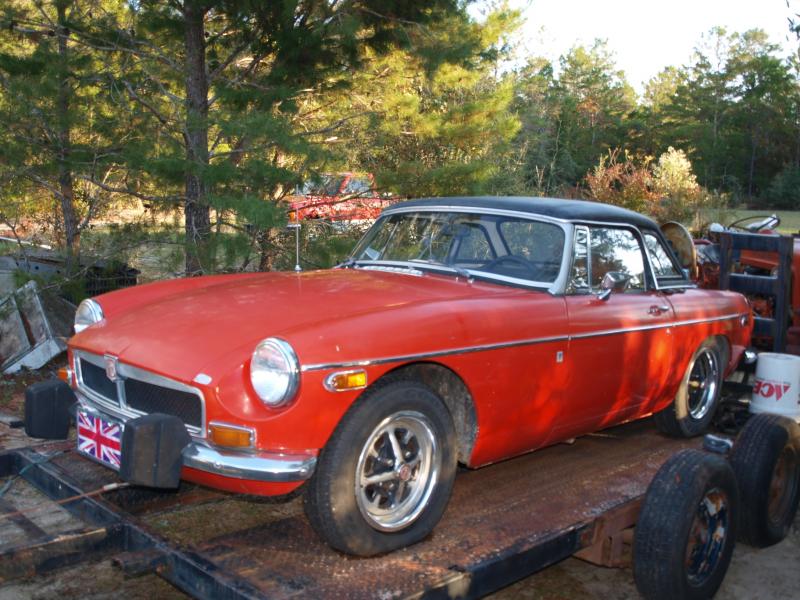

Back to MGs, the Lucas alternator in my '74 was putting out 16 volts and made quite a mess of the wet lead acid battery that was in the trunk when I got the car. I am cleaning up that mess now after my battery change and a new Delco alternator. Lots of things to do to it yet, but just trying to put it on the road for this summer. It is in good condition other than a lot of interior work and a good paint job down the road. Helping to keep this old retired guy off the streets and out of trouble-haha
Platinum
Looks good. "SnugTop" hardtop... nice.
I recently converted our B to an alternator, did the negative ground change-over back in '05~'06 during the rebuild. Added a period correct voltmeter and clock from Nisonger on a bespoke center console.
