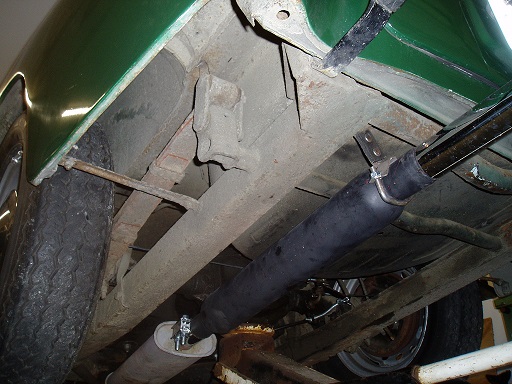

CJD
As shown in the pic above, the main muffler is forward of the axle, and the resonator is behind. Without the resonator you just have a straight pipe behind the axle. If you purchase a resonator any muffler shop can install it pretty easily by replacing the straight pipe with the resonator + tailpipe. I would just think that would be much cheaper than replacing the entire system when you only want to add the resonator??
