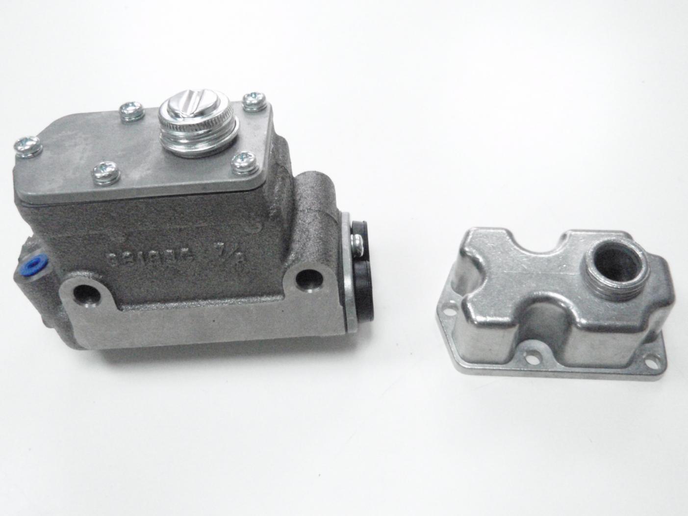

That cap adder is for the 1600 and later MGA's (when they went to disk brakes).

Moss wants $49.95 NO CAP I found a place that will sell me them for $39.95 if I buy 5 and they have a nice reproduction metal cap I need to know if there are 5 people interested I can also get the 7/8" master cylinder in the picture for $129.95 each but again I need to buy 5 so if anyone is interested let me know.
