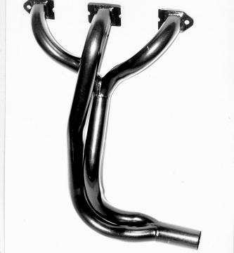

Will that header fit with the stock carb heat shield? That was something Hap mentioned to me -- a difference between a race header and a street header. I know nothing about headers, just that I need one. /bcforum/images/%%GRAEMLIN_URL%%/smile.gif

Drew, I don't know about the stock heat shield. My suggestion would be to call APT and ask. The street header number is EXL9.

Jeff -- I looked at the APT website after you posted, and wondered if that was the one you were pointing out. I'll be giving them a call (among others) to see what will work for my application. I'll be making a lot of calls in the next few months. It's gonna be fun!

I have the APT maniflow LCB header and it clears the duel SU carb heat sheild with no problem. Along with the header I would recommend the maniflow muffler and pipe to complete the package.

Thanks, Liam. I was fairly certain it cleared, but didn't want to say anything unless I was absolutely sure.
I concur with the recommendation of the remainder of the system.
