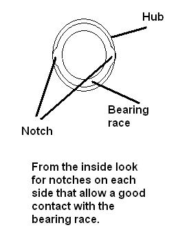

Now look at the outer side of the large race and from the inside you should see a notch on opposite sides of the hub, just large enough to get the edge of your drift onto the edge of the outer race, then drive it out a couple of taps on one side then the other. It will eventually pop out. Then the same for the inner bearing using the notches in the hub for it as well. To install the new bearings you'll need a driver that fits the outer race of each bearing, don't want to drive on the inner races at that can damage the bearings. If you buy the bearings locally the part store can probably press them in for you at very little charge, or any auto machine shop can do as well. Probably better than driving them in unless you are experienced and know how to avoid damaging the bearings.

Everything is out - here are some shots of the grooves where you fit in your drift, as explained.
