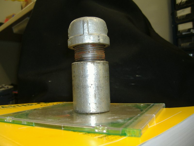

A relatively inexpensive bearing installer can be made from a piece of pipe and a pipe cap. Just go down to your local hardware store and find a piece of iron pipe that is the size of the outer race and a matching cap. Grind the end as necessary to fit inside the hub and screw the cap on the other end for a driving surface. This also works well with bearings on long shafts such as transmissions as you can get a pipe section long enough to clear the shaft. If the pipe isn't quite the right size try a smaller size pipe with a coupler attached. Here's one I made to press a bearing at my job.

Thanks for the posts. Bill, I've made a note of your solution- good thinking.
