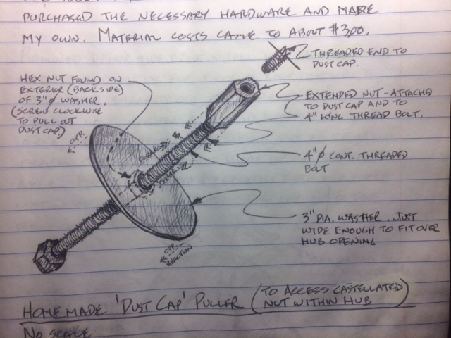

I have the real McCoy tool I've used to remove my stubborn dust caps, but here is the actual drawing I readily have and used to make the tool. And as my note indicates, $3.00 was about all that was needed to make this. Hope this helps a bit...
The extended nut above is a 5/16-24 fine thread coupling nut if asking for it at a hardware store. Somewhat hard to find - usually they are 5/16-18 coarse thread. Bolt Depot has them:
I made my cup remover too, and a hub remover, but found that I did not have to use the hub remover - not on the fronts anyway.
