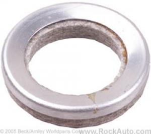

These are photos of two wheel seals offered by Rock Auto. The first being the traditional type and the second the "other" Timken type (#480991). What do you guys think of that one?

CinneaghTR said:
...the second the "other" Timken type (#480991). What do you guys think of that one?
The worked out perfectly on the last boat trailer I fixed.

I am going to order a set of these Timken rubber (or rubber type material) seals and see how they work or if they work. Won't cost much to try!

I bought the Timken that were listed for the TR-6, but they did not fit correctly. Put the old felt ones back in. YMMV.

How are your wheel bearing seal blues going? I "attempted" to install my hub yesterday and started with the Beck Arnley/Rock Auto felt seal. I cut it down, probably too much because it was not longer pushing against the bearing race, and the hub still would not move in enough to clear the cotter pin hole before locking up. The Timken-spec'd seal did the same thing. I inserted it with the cup-side toward the car.

I ordered the rubber Timken seals. They did not fit and I will return them. Just had to try them.
