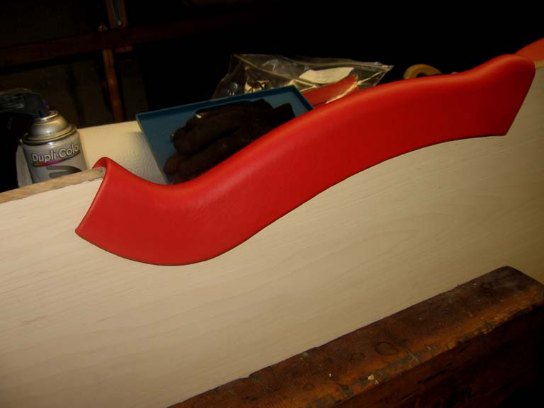

I see them come up on e-bay all the time, and I think it might be the best alternative. Besides that, getting the vinyl on there (I used leather) without any wrinkling in the lower crook takes a bit of work to get it stretched properly. Probably the reason they used steel rather then aluminium as they did for the rest of the cappings.
I also made a wooden jig as shown on this pic to stretch the leather on the dogleg. It was submitted by a member of the forum. I'll see if I can locate that thread that shows how to cut the wood.
Edit: BTW, mine are not on the car yet, so I can take some measurements so you can see how they relate to the fiberglass ones. All measurements will be with the leather folded over on the inside. They do fit over the car. The initial opening is not the same throughout the piece, but generally measures about 1.25". It narrows a bit as it gets toward the curve...maybe an 1/8" to slightly more toward the front.
Edit again: There is also a twist in the piece so they can only go on the correct side as the body is curved back there.

Splitting them, then filling them with epoxy might make them too weak to withstand the amount of force it takes to push, pull, tug, and tuck the covering over this particular capping. It could very well crack down the center, while your trying to cover it which would be discouraging to say the least. I covered mine with leather and built a similar jig seen above. I did mine in stages, and all told, took probably about 2.5 - 3 hours of work of trimming, etc. to look nice. At times, I had to put a lot of force on that bad boy to pull the wrinkles out.
My advice is to return it and get original parts from a used parts supplier.
