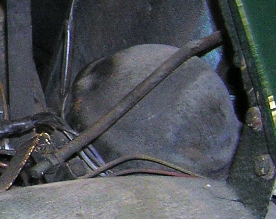

TR4nut
Take a look at PC100011.JPG - Isn't that the bolt Nick mentioned on the left side? Those need to go.

Hatman
Actually, that one (and the other three behind the grill) are gone. I snapped that pic before I removed them all.
I think it's probably just the apron is pinched in there. I'll work with it tonight, loosen the fenders if I have to, and see what happens.

Uhm, Don, those are the radiator support rods in your photo. They do NOT need to be removed when removing the front apron !
The rods mentioned earlier are the supports for the handcrank support, underneath the apron (to tabs welded to the frame). Since the handcrank support itself is missing in the photos, it seems likely they are not the issue.
Hatman, those are the bolts we were discussing, but they do NOT have to come out. Just lift the curved tube away still attached to the apron.
