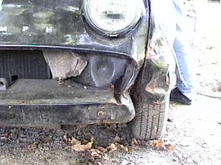

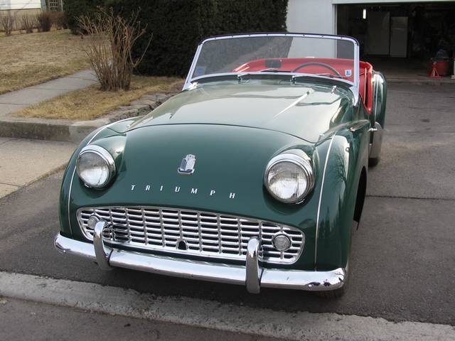

We restored a late TR3A that had been smashed in 1996, then sat under a tarp for 4 winters and 4 summers.
That was the "before" photo. Here it is in 2006 when we finished it. We are just careful rookies at this.
Looks like a professional job to me. How would you like a free place to stay this winter in sunny warm AZ. There is a small catch though.

Greg, here is another picture to help you sleep!
This is what I did to my TR3 one rainy day about 15 years ago. An old panel beater called George tapped it all back into shape and I loved the way he shrank the metal back using a blow torch, mallet and dolly!

There's a picture of my beaten-up TR3 in the second post in this thread. The auto body artist I took it to says he's going to straighten up the rear wing. I've seen the "before & after" album he keeps. It's possible. Though, I sure don't know how it's done. The cat's good!
