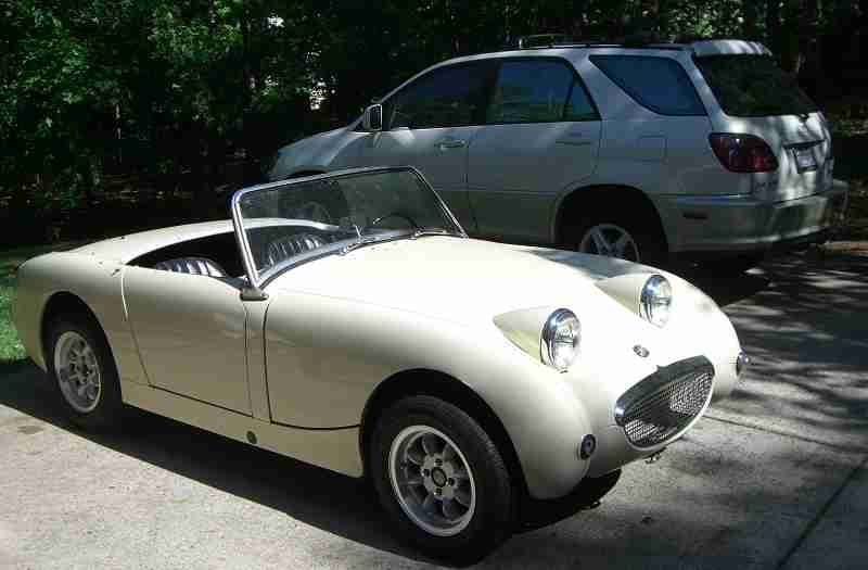

I have just tried to install the new Superlite wheels on ncbugeye, 13" by 5.5" with 175/70 R13 tyres. It is important to recognise (with hindsight) that she has the front disc assembly from a 1974 Midget installed, so she is not a standard Bugeye.
When I installed the wheel it fouled the top of the stud on the track rod end, and definitely will not work like this. Is there anything I can do, or do I have the wrong wheels. At first sight, if I were to take a hacksaw to the stud and cut it down to flush with the top of the nut, it might work. But after thinking about it, this might be a bad idea.

Everyone I know have filed the tie rod end nut. Especially the castellated ones.
File away!

Is the 13x5.5 the same size they fitted to the end of line Sport Pack Minis? If so, on those they had to fit big ol' flared arches to cover them, presumably they had spacers on to clear all the gubbins and still let them turn.
You'll probably need some wheel spacer, Winners Circle has them. My only experience with 13 x5.5 is the LP race car, in fact you got a set from the race car, on the race car because of the flares and the rules allow an increase track, I ran 1" wheel spacer with the long 7/16" wheel studs, you won't need that much spacer, but Winner Circle has them in alot of sizes up to 1"

I cut mine off and did not have to cut into the nut at all. It all clears by almost 1/4 of an inch. It will not hurt anything because the nut is already on there. If, someday, you need to replace the tie rod end, the nut should re-thread what it needs to come off just fine.
Or, you can buy the spacers that Hap is talking about.

I do have the front disk set-up from a donor. I used a pneumatic cut off wheel for the two of mine. And then dabbed a bit of paint on the cut to help resist the temptation to rust. I think you should be able to use a hack saw, but it will of course take awhile--and take a bit more care not to get into the nut.

OK, so I am now the owner of a nice Makita grinder. The job took 10 minutes.
Tadaaaa, and here is a pic of ncbugeye with shortened track rod arm studs and her new Aussie SuperLite wheels. Hot stuff...
