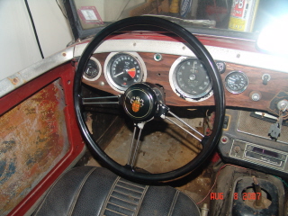

I bought a MKIII Banjo Wheel for my Bugeye and it fits just fine. I tired to go back and find the thread, but the steering column size did change over the years, but a MKIII will fit. The only problem is that a bugeye has a horn in the middle, whereas a MKIII had the horn on the stalk, so I'll have to rig something up. I'll try and find a photo, but it does work.
John Moore
I think mine is from a '68, but I don't remember. Here's what it looks like in my bugeye.

Yep! I wish I could find the thread, it's somewhere in the archieves during the past year. But the BE has the same column size as the MKIII... I think. Like I said they changed from 3/4 to 7/8" and back and forth.
Like I said, the only thing that isn't a direct swap is the horm. You'll have to figure that out as the '68 wheel doesn't have a push on the middle button.
Good luck.
PS - I would ask the Ebay seller to measure the spline hole.
