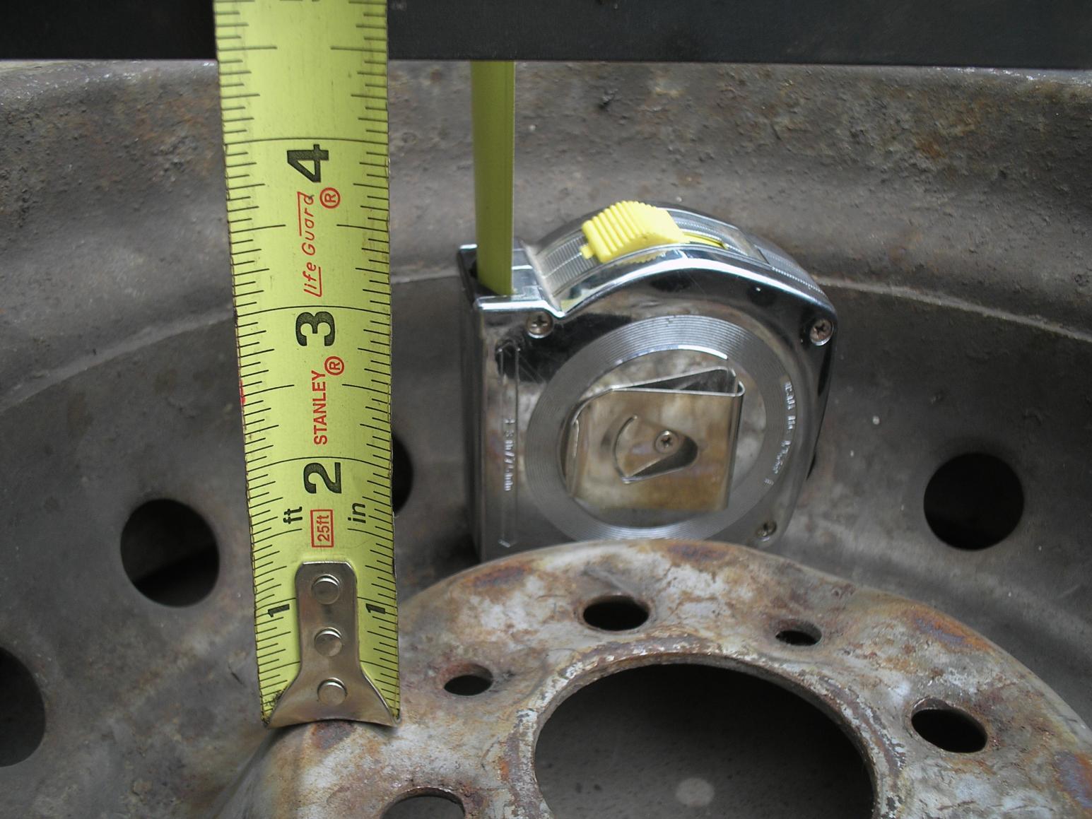

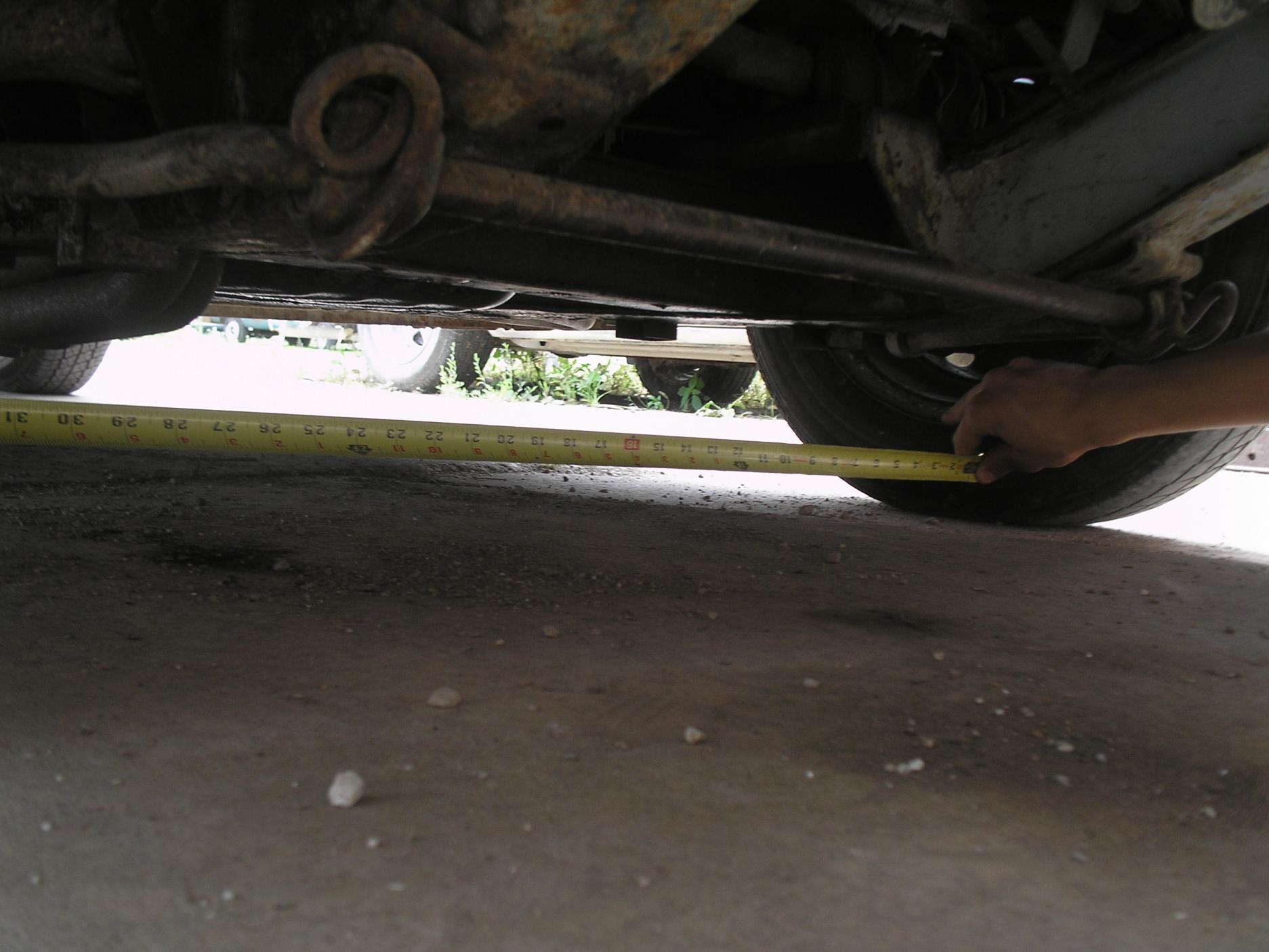

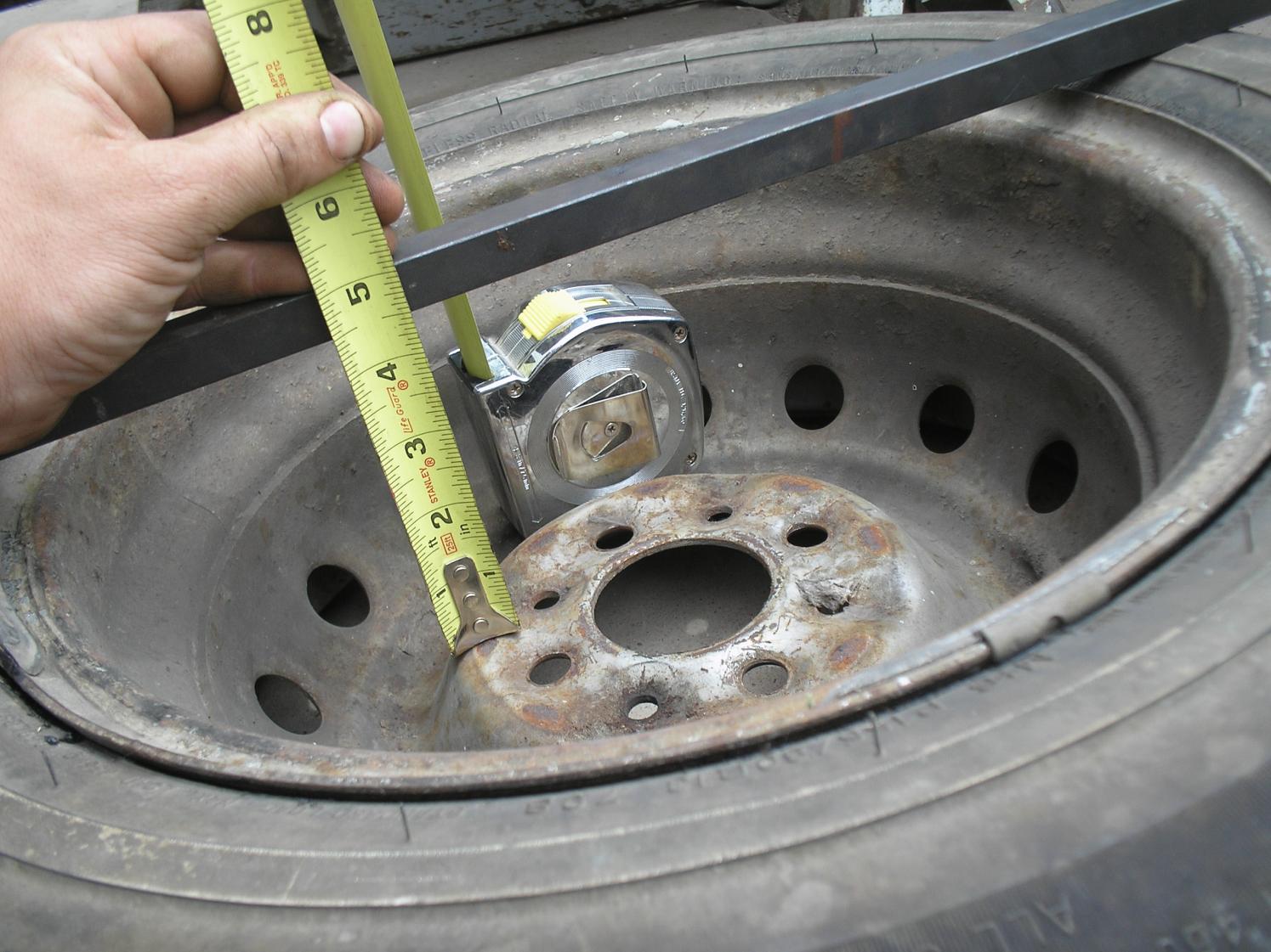

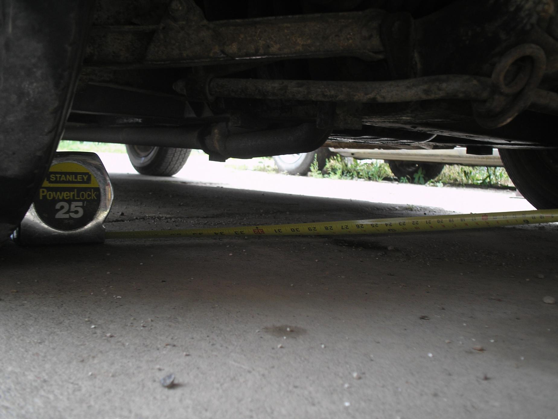

On my 65 Spitfire the distance from the wheel mounting surface to the same on the opposite side, is roughly 51 and 1/8 inch. I'm not sure how precise my measurement is. I arrived at this number by measuring across the inside of the front tires, with my car sitting on the ground (see pics) and then adding the difference from the mounting surface on the rims to the tire sidewalls.
The measurements were 39 and 1/4" between the tires, plus the 3" for the tape measure body. The distance between the inside side wall on the tire and the mounting surface of the rim is 4 and 7/16" per side.
I hope this helps.
