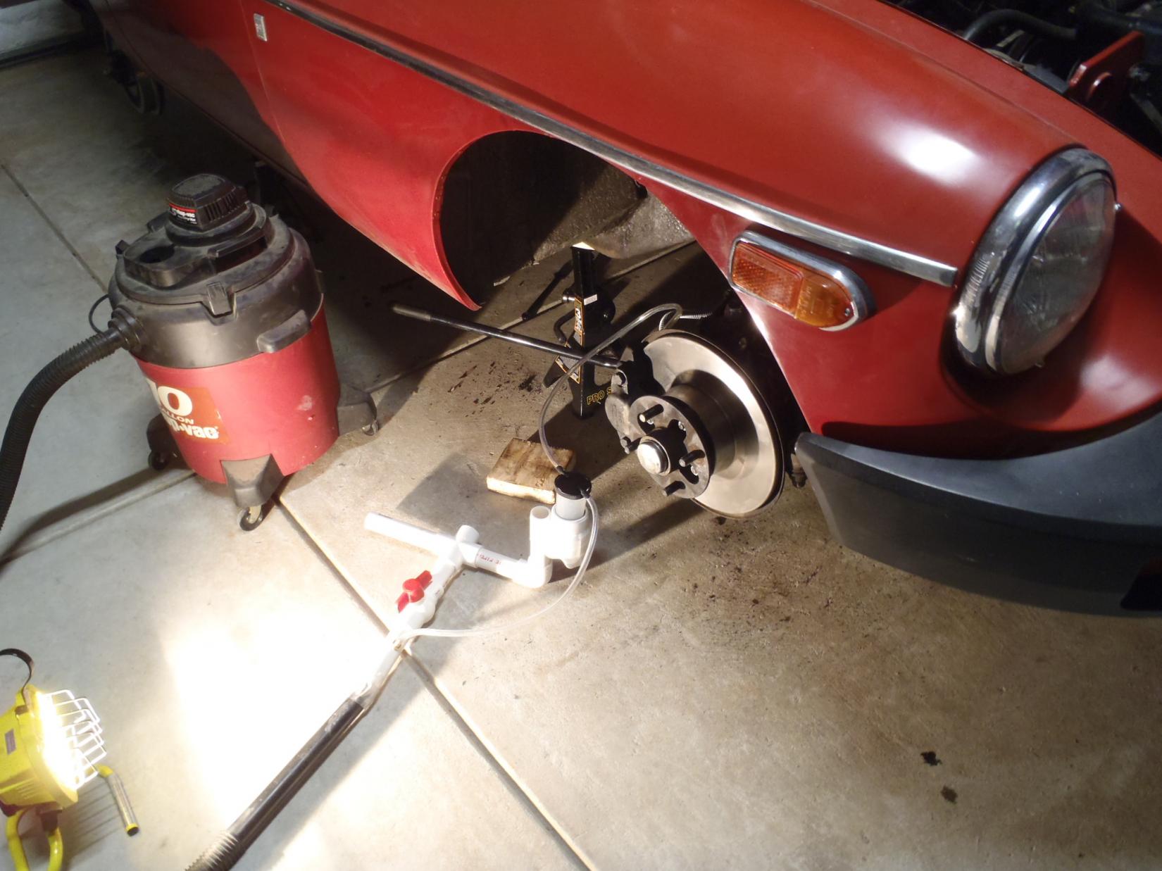

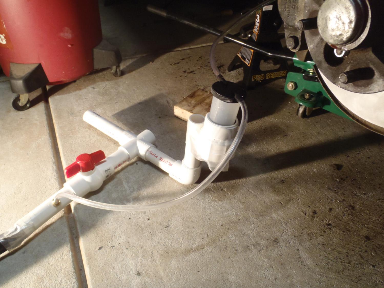

Wow finally a victory!! I have always feared bleeding brakes. I have a Mityvac brake bleeder and had success on my BMW motorcycle but no success on the MGB. I kept getting bubbles and wore my arm out pumping the handle. I looked online and found lots of ingenious ways to use a Shopvac as the vacuum source. I made this unit using PVC fittings and some tubing along with a barbed nipple. I used the small vacuum container from the Mityvac unit and let the Shopvac do the rest. Most of the unit is just for convenience (such as an arm and cup to hold the vacuum chamber) and parts cost $15 at Home Depot. The PVC valve was used to regulate the vacuum. The Shopvac is upstream of the valve along with the bleeder vacuum line. The downstream side is open to air to let the vac breathe. As you close the valve it restricts the flow and increases the line vacuum. Worked like a charm. Half an hour and a quart of fluid bled (mostly to insure lines were cleaned out), got in the car and the brake pedal is ROCK SOLID!!!:excitement:

I looked the up the Eze bleeder and this is another innovative way to get it done. I did get a lot of crud out of my system, along with old dark fluid, and wonder about pushing it back in (if you are talking about the syringe unit)? I already had the Mityvac unit and just wanted to avoid hand pumping, this did the trick.
