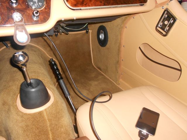

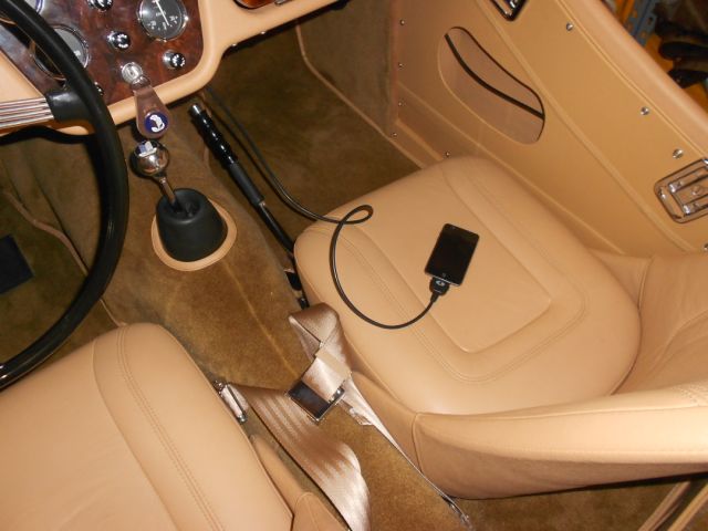

rusty55
Ipod

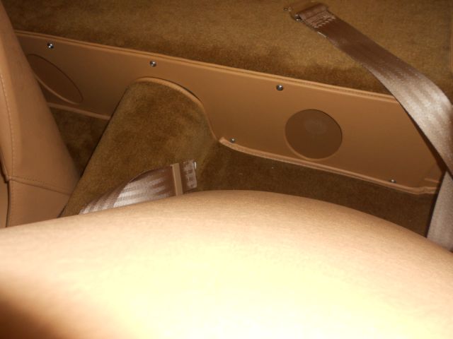

rusty55
front speakers ( i still need to zip tie the speaker wires up a little)

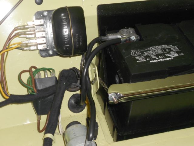

rusty55
Power from battery to amp

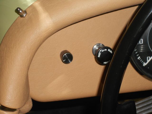

rusty55
and finally, the volume control
