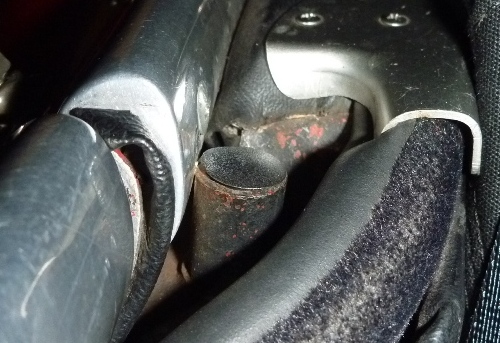

there are a few threads regarding this subject but nothing totally definitive. after a search of bj7 model picures the antenna if present was located in the passenger front fender or in a similar close proximity in the shroud. well mine is in the shroud above the package shelf on the passenger side. the shelf had been removed so that the retractable portion of the antenna would...retract. i dont care for a radio nor the remaining antenna hole. and, the body shop tells me that they will have to repaint the entire shoud if they fill the hole.....lots of dollars! so, i will most likely replace with an antenna in the fully down position. any ideas or suggestions of other ways to attack this. View attachment 33188

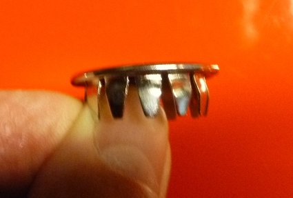

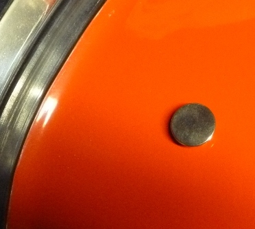

Another possibility - look at it like a craft project.
Epoxy a piece of aluminum behind the hole. Cut a matching hole in a piece of wide teflon tape and use it as a mask. Fill the hole with surface putty. Contour carefully. If it needs sanding and the teflon tape* mask won't work, make another out of duct tape and carefully block sand to same height as surrounding body work.
I beg to differ about the paint - a good painter should be able to match the paint and paint a small spot with a feather edge.
I might be tempted to spray over the area through a circular mask held above the bodywork - to give a feather edge - then color sand with very fine wet/dry paper.
*google Dyna Glide for the teflon tape.

I might also try the plug that Steve pictured from the Home Improvement store and painting it to match the body, but I still don't think it would look as good as the antenna.

thanks guys. it is still hard to imagine someone drilling unnecessay holes into the shroud area to mount an antenna! think that i will purchase a chrome retractable antenna and modify the antenna below the mounting point such that it does not interfere with the package shelf...if it can be modified. i ordered the chrome retractable off ebay...10 buckx shipped. cheap experimentation for a possible fix!
