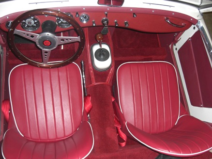

smaceng
I bought the Moss carpet and vinyl kit plus extra vinyl and carpet should I desire to finish the cave. It was a good match on both. Now all I need is a small person to climb back in there, measure and install. Any volunteers?
Scott in CA
