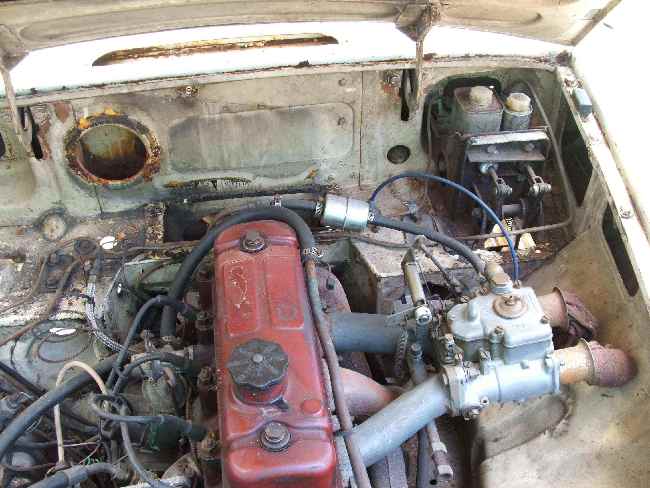

Just thought I would posat a few pictures of the progress on my Wife's 1966 MGB...
The engine is pretty much finished as is the tranny and carbs... I will be leaving
the engine on the stand until I am done with the engine compartment...
I am already suffering from ' JUST AS WELL...' with a rebuild of the heater and, likely,
a new wire harness... and brake/clutch master rebuilds...ad infinitum. :smirk:
And finally
<span style="font-weight: bold">QUICK... CALL 911... I am stuck under here!!</span>

Gettin' there - you gonna strip & repaint the engine compartment before the new engine goes in?
ronzet
ronzet
Tony,
Yep... I have already rebuilt the chassis - front and back...
I will not undertake a full teardown of the car to produce a show version since this is a driver... but, I am now into it far enough that the major subassemblies will be replace or repaired... Once the engine compartment is stripped down, I will paint it the body color using the PPG paint system. I will be rebuilding and painting the master assembly, heater core assembly, and probably replace the wiring harness... In removing the heater core I have half-way disassembled the dash so that will be removed and rebuilt/painted...
The last projects will be the body/paint and interior... Hopefully before the second coming... :smirk:
In summary... I am moving from the inside out and the front to the back....

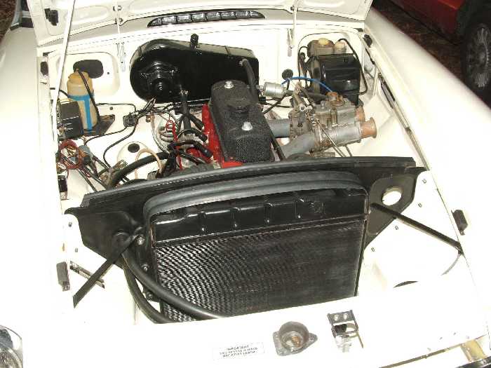

That looks sooo familiar... I've tossed these out before, but as some incentive for ya:
Platinum
Final, done with engine in-situ... was a REAL pain inna butt, too:

I need to ask... was the repaint of the engine compartment done at the same time as the rest of the car or did you proceed in a like fashion to my plan???
Thanks...
Platinum
I did the whole thing as a "panel job". One section at a time, OUTDOORS. The bay was done as one "section". I did remove hood, bootlid, doors to do them, jambs were shot to all match the GALLON batch of O.E.W. I got. Likely took me twice as long to do it that way but I've no place to pull it all down and do a "proper" job of it.

<div class="ubbcode-block"><div class="ubbcode-header">Quote:]done with engine in-situ... [/QUOTE]
Just to clarify.. you painted the compartment with the engine still in or after you yanked it out??
If you had left the engine in and painted I am amazed at what a good job you did.... I am intimidated by the job with the engine out!!
Engine stayed in. All wiring and plumbing were moved out of the way and masked. The engine was covered with plastic. Then all lines were individually painted with the panels masked. Rewrapped the harness, put all back into place then masked THAT and sprayed the engine. Did the valve cover with crinkle black as a lark.
Again: This is NOT a full resto... just a refresh. When the clutch or gearbox have to come out I'll get picky over the parts I couldn't easily get to under there.
Tony said:
See, I find it easier with everything out of the engine compartment.
Absolutely agree, Tony. But as I said, I've VERY limited storage and had no choice but to do it outdoors. It's a cheat! :smirk:
