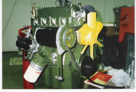

I need to see examples of how everyubody painted their engines...out of car...both sides...front/back.
I'm in process of taping mine off, cleaning & priming & I don't want to paint a surface that should be left raw!

Tony, this is the best I can do on short notice.
Jeff

Thanks Jeff - are your freeze plugs painted?
& what about the 1100 tag hidden by the oil filter?
& I know Jack has a couple!
jlaird
But why is the generator black. Greeeeeeen like the engine. Same with the lower pully.

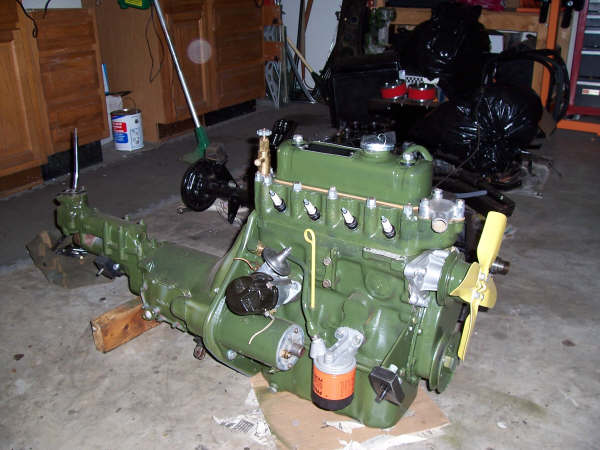

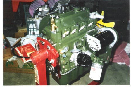

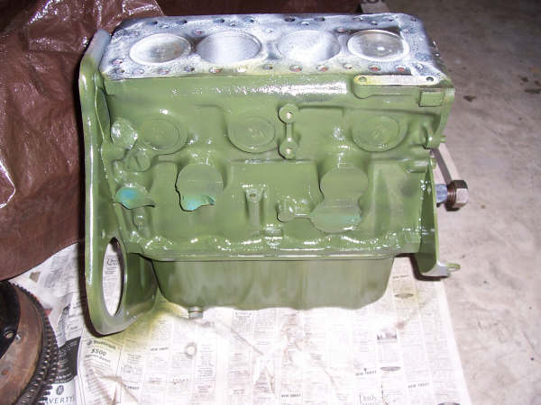

Jack, your photos please!!

Tony, the plugs are unpainted, but I'm pretty sure I painted over the 1100 tag, if it even had the tag on it.
That engine is in my California '65, so I can't just run out and take a quick look!
Jack, all of my 1098's have a black generator on them. All of the 948's are green.
The lower pulley is a dampener from a 1275, and should be black.

Okies.

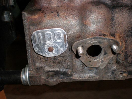

Jack - what about the little size tag (mine says 1100) on the carb side down low on the front....is yours painted?
jlaird
No tag on mine. If there was I think I would not paint it, is it alum and rivited on?

Yep.....Aluminum & riveted on
jlaird
Do not paint. It was added after the fact I would bet. Just like the engine number, don't paint that either.

Here it is...& I've not done any cleaning since I brought it home from the machine shop....if you look closely, you can see a little of the original paint left on the tag after it was tanked making me think I need to paint it.

I think I would paint that as well. Never saw one before. Wonder what it indicated really?
Maybe someone here knows?

Well, remember this is the 10CC engine - the 1098 that has the enlarged 2" main bearings....its possible they just took the blocks that were already cast & modified them for the new crankshaft & this tag is how they designated it - who knows?

I can't speak for the 948's, but my 1098 is a CG and it has the exact same tag.

Is it painted?
healeyboz
I sold a 1098 last year. I was a front wheel drive that was taken out of an Austin 1100. It had the same tag! And I do not believe that it was painted.
