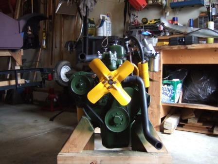

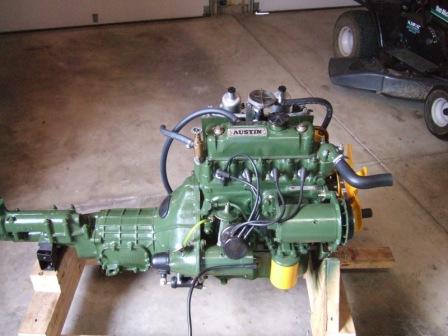

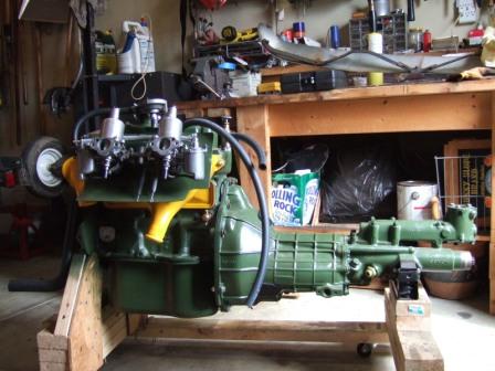

Tony, wanted to share my colors. My engine was a gold replacement engine. What I have painted yellow were originally yellow. I striped the yellow pieces down to the bare metal and there was no green to be found so I kept it.
Mark

Mark - thanks for the photos - they're helpful
Sprites & Midgets were a little different tohugh...MG didn't paint the transmission & sprayed the entire engine with all the covers after it was assembled...for example, my rear generator mount is green except for where it's bolted to the block & that's never been painted....& the thermostat cover was never painted - its just raw aluminum.
And your photo brougth out more questions on the fan & its pulley...both yours are yellow; Jack's pulley is green...mine was green w/yellow fan???
And I now have questions on intake/exhaust manifolds...I thought they were silver but yours is yellow!?!
Man oh man!
Exhaust and intake were not painted Tony.
Pulley was green with yellow fan blades.
As mentioned my fan and pulley were also yellow down to the bone. Maybe this yellow was only used on gold engines. The manifold was also yellow. If you think about it these would all be caution areas due to heat or movement except for the oil cannister. As I said in my original post I have wondered why everyone else was going straight green.
