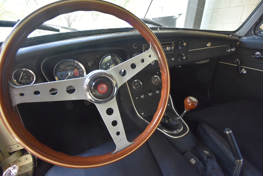

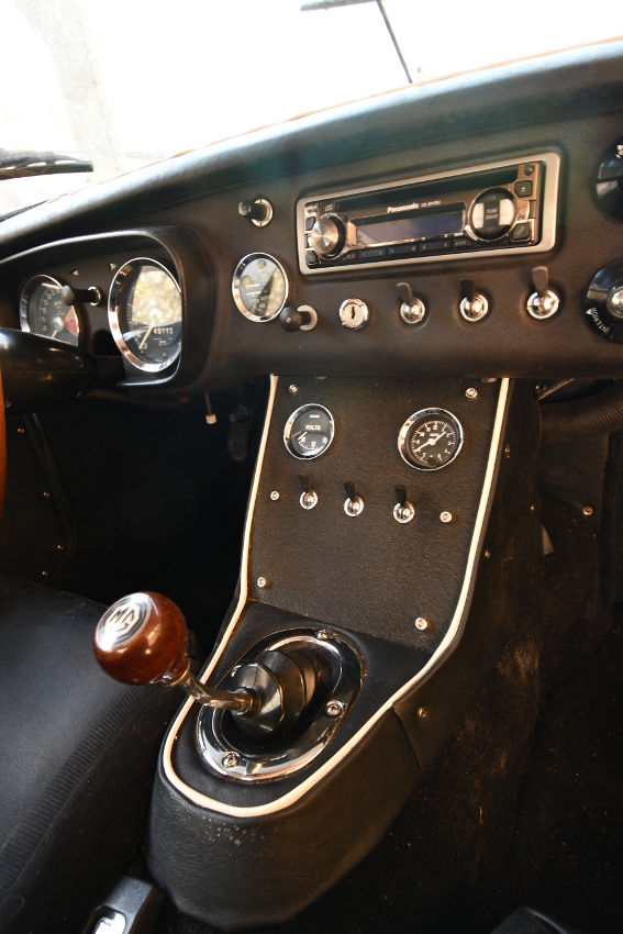

I can’t really see for sure, but there should be some welt between the crash pad and the top of the facia.
It's there, and proper black.
We did mine with white welting, just for the contrast. For the padding on the facia top edge I used a "pool noodle" carved it to shape with an electric carving knife. 😉
Grantura_MKI
I was referring to OPs picture, Doc.
My B originally had white piping, so when I redo the interior I might steal that trick you have done.

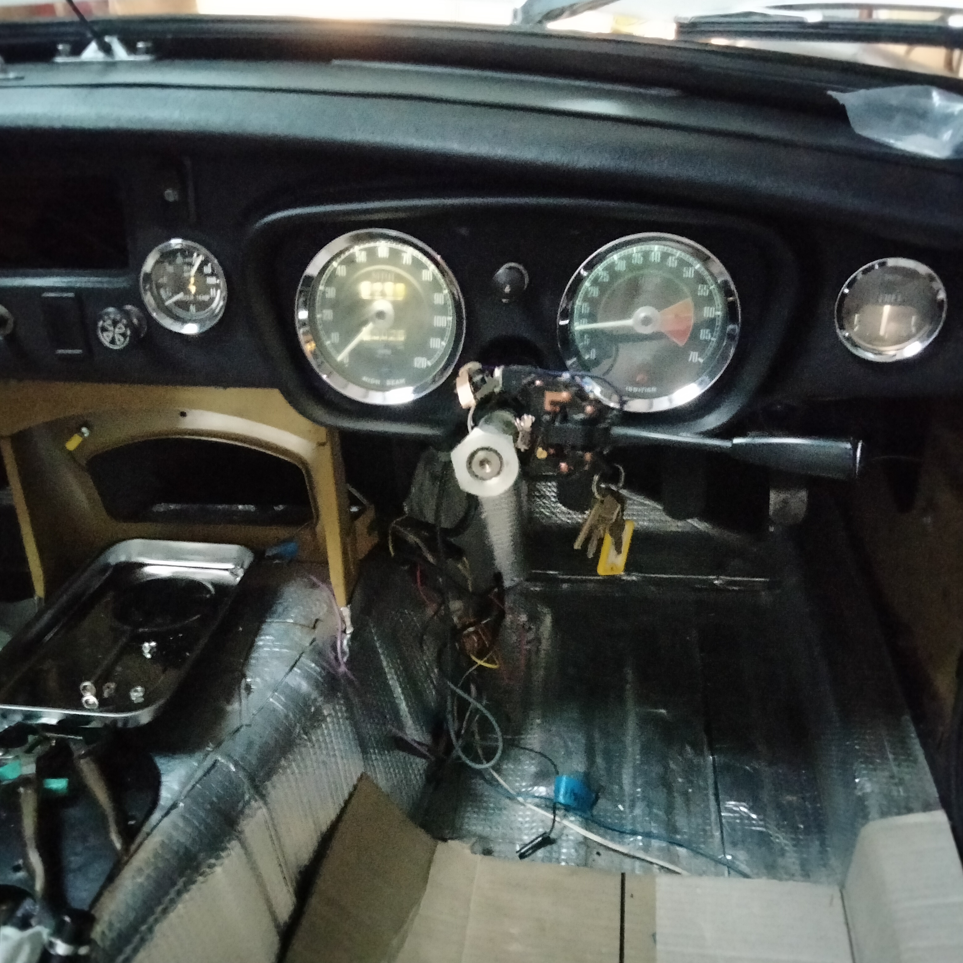

As JP states, NO "permanent" sealant for the bezels. Scroll up to my #16 post above. Here's another llink >to Nisonger Instruments.< They sell the gasket set for all the gauges for skinny money, even with the cost of the shipping. Save yourself the aggro.
Otherwise, looks like some good progress!
That fitting for the oil pressure gauge had a small diameter flat seal for the seat, may still be in the ferrule? ISTR it was thin leather originally, but I may be mistaken. Again, no sealant, the fitting and ferrule are a tapered seat. Look for it on Nisonger's site at the same time as the gauge gaskets.
Keep us posted. 👍

Hiya, D! The OP has the welting in between facia and pad, just in black.
My first B, a '66 had it in white, I did this one the same. Glad you approve of the added console.

I have found a supplier for the replacement o rings for the gauges so going down that path. I kicked her over for the first time
after putting everything back together it sounded great

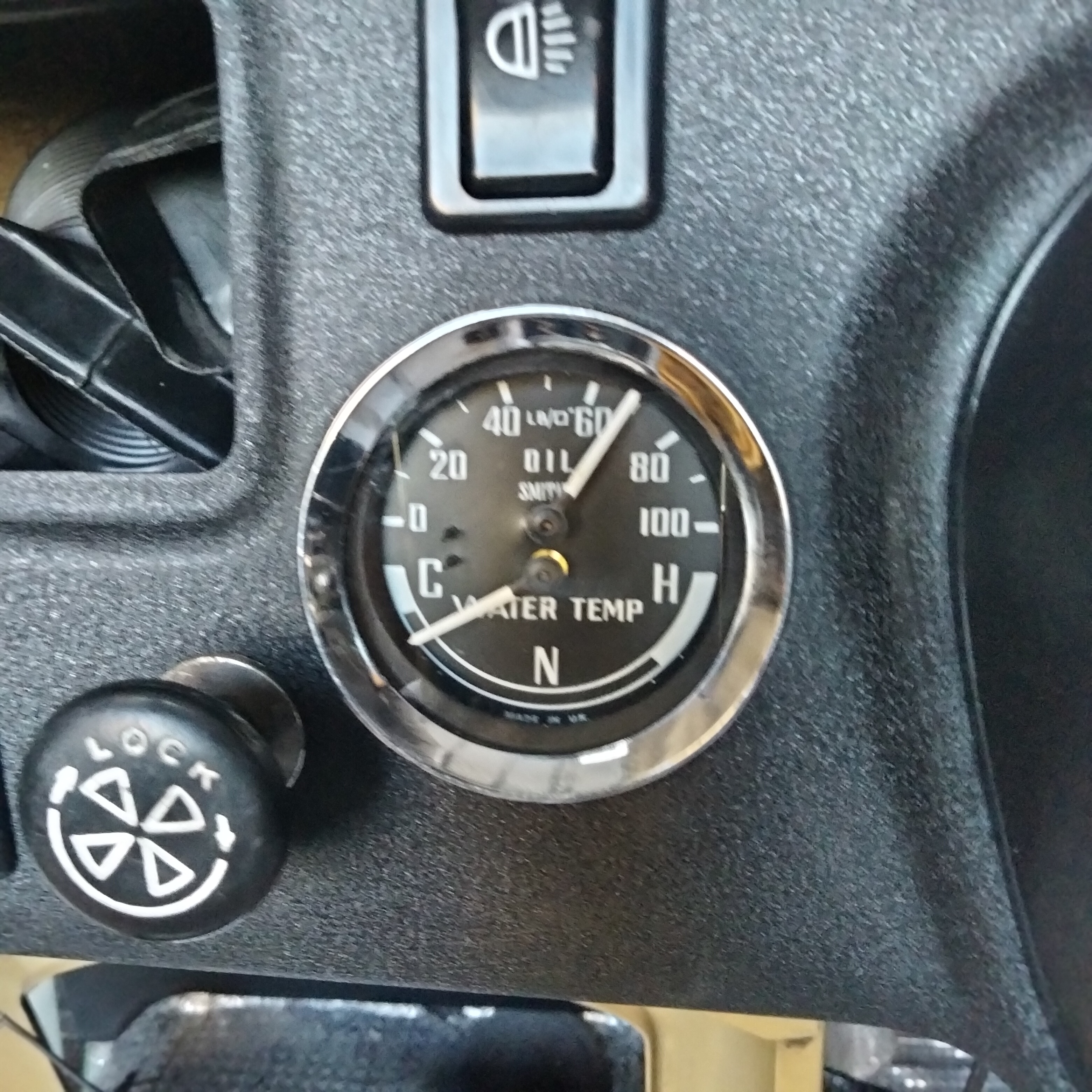

I ended up taking all gauges apart cleaned and put new o rings in they were oversized so cut then glued them to make correct size attached two photos one a close up of temp gauge I cleaned and re installed and working all went well.

Guage looks good, Chris.
As for that choke cable lock, the steel ring that "locks" the cable is spring steel. Mild steel is likely to fatigue and fail rather quickly. You ~may~ be able to fuss the "dimple" in the spring with a rounded punch, but frankly that's more trouble than it's worth, IMO. We replaced the cables that stopped working.

And I finally got around to getting a couple wide-angle photos of the dash here in our '64:
Platinum
Chris,
Looking at the photos you'd posted earlier of your dash, I just noticed there's what appears to be an original 3rd/4th gear overdrive switch just right of the fuel gauge? I know yours is a later car, with the four-synchro gearbox. Does it also have the overdrive unit fitted?
If so, that's really nice to have! >jealousy icon here<
Ours here is the three-synchro box, no overdrive. The switch in the position is a headlight switch, intended for an eventual set of period Lucas "Flamethrower" lights. First position on the switch is for the fog lamp only, second position lights both pencil beam and fog. Just now I've a set of Lucas "Square-8's" mounted beneath the bumper, wiring and relays fitted.
