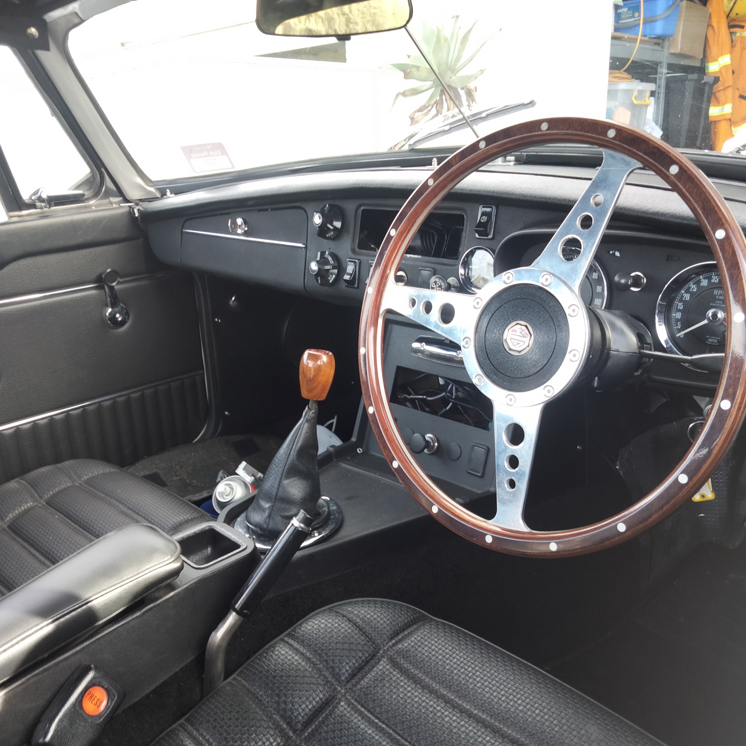

Looking at the photos you'd posted earlier of your dash, I just noticed there's what appears to be an original 3rd/4th gear overdrive switch just right of the fuel gauge? I know yours is a later car, with the four-synchro gearbox. Does it also have the overdrive unit fitted?
If so, that's really nice to have! >jealousy icon here<
Ours here is the three-synchro box, no overdrive. The switch in the position is a headlight switch, intended for an eventual set of period Lucas "Flamethrower" lights. First position on the switch is for the fog lamp only, second position lights both pencil beam and fog. Just now I've a set of Lucas "Square-8's" mounted beneath the bumper, wiring and relays fitted.

Yes it does have an operating overdrive it was serviced when engine was rebuilt it drops revs by about 500.
The engine was rebuilt in Jan of this year.

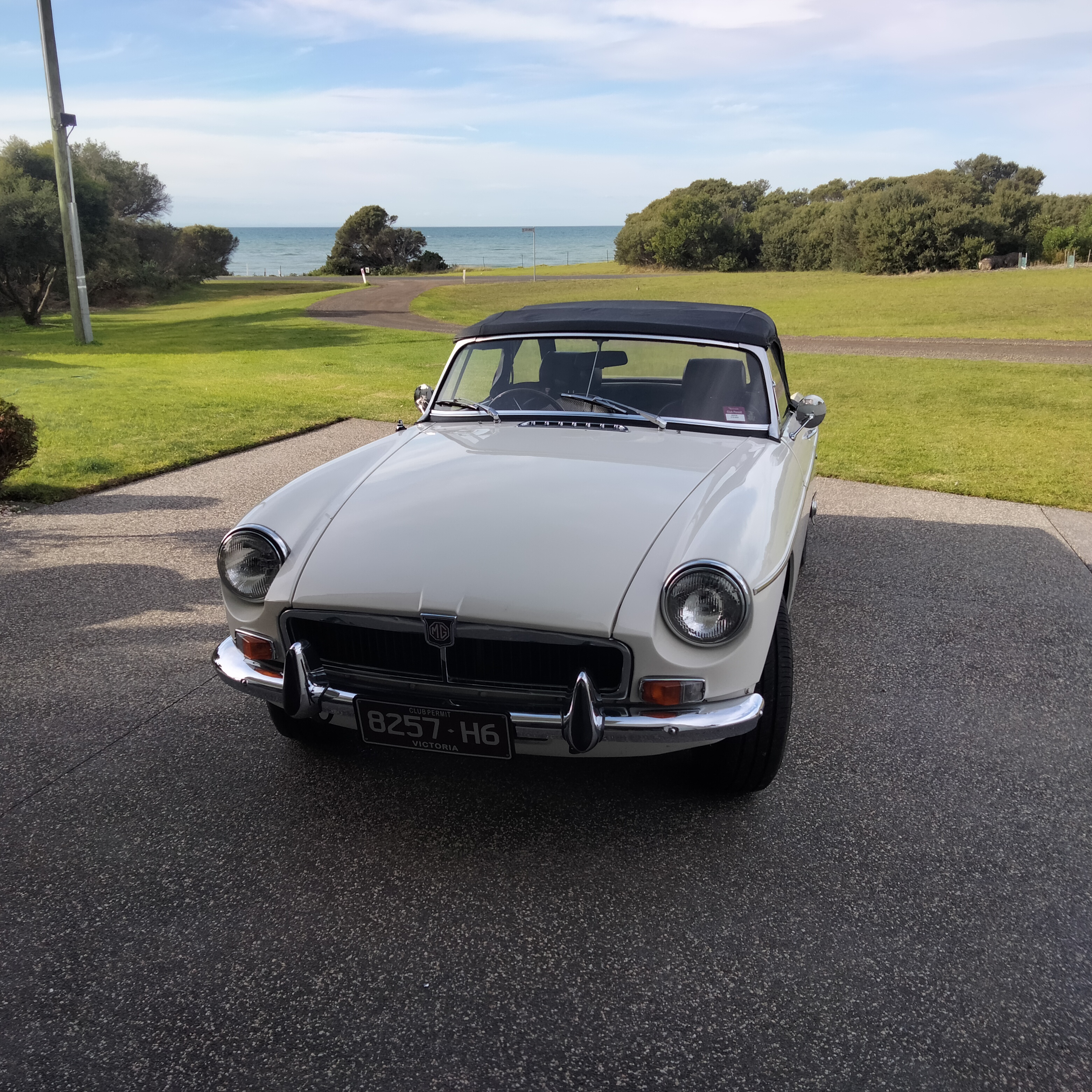

like the look of your b very nice got any other pics of it and your other cars ?
Chris
Lots of pix, many posted here on the Forum. The "traveling media" banner at the top of the Forums page has 'em "en passant" sporadically.
If you go to the "Groups" heading, in "Photography" there are more pix in my posts there.

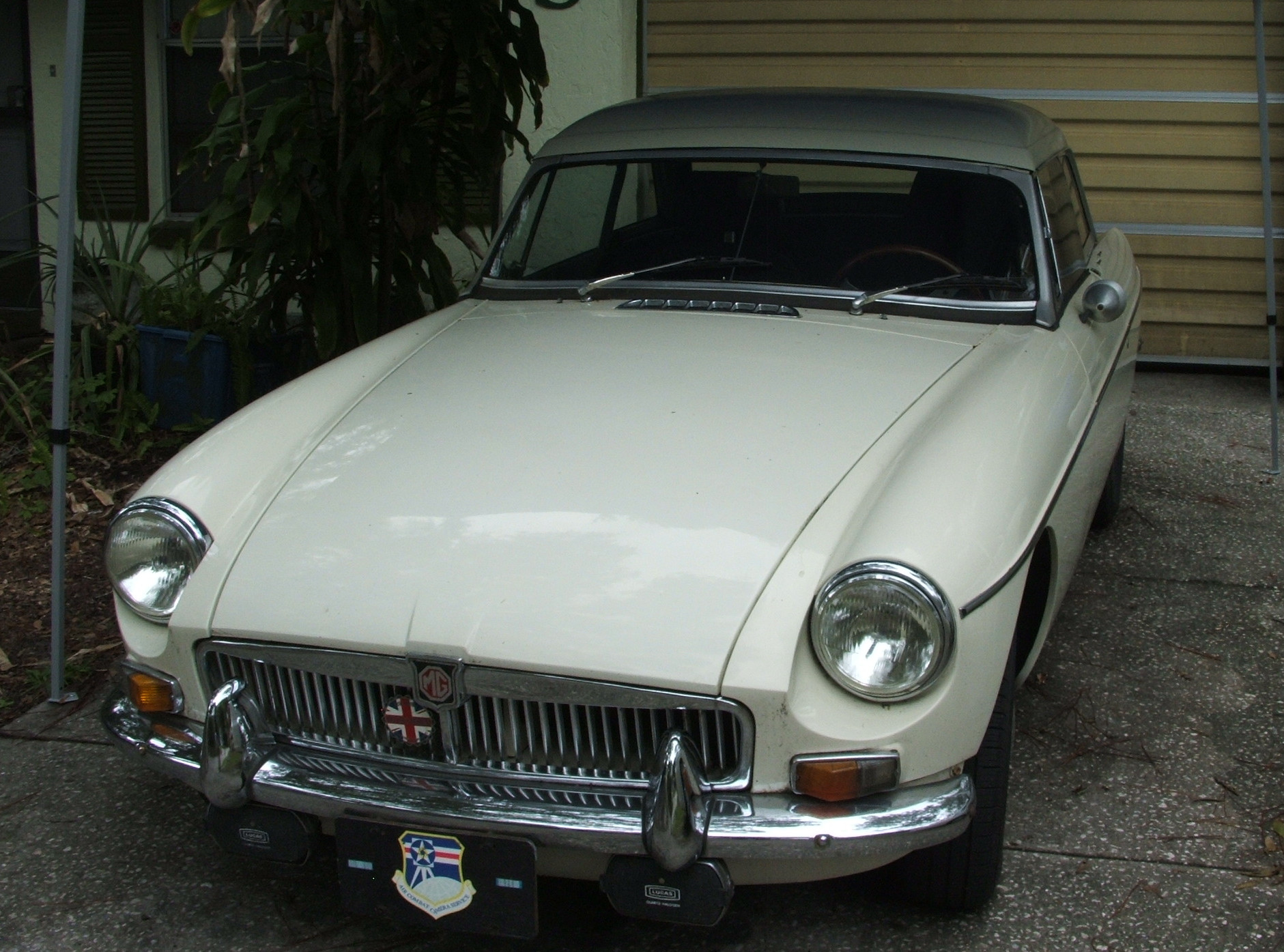

The current MGB:

Headlights are a "try 'em to see if I like 'em" Lucas LUB319, left-hand drive (US) 7" envelope with halogen bulbs. May see if I can find an appropriate LED to fit. If not I'll change back to a Cibie enclosure and H-4 LED substitutes. Have yet to get LED replacements for tail & front running and brake lamps. Life events interfere.

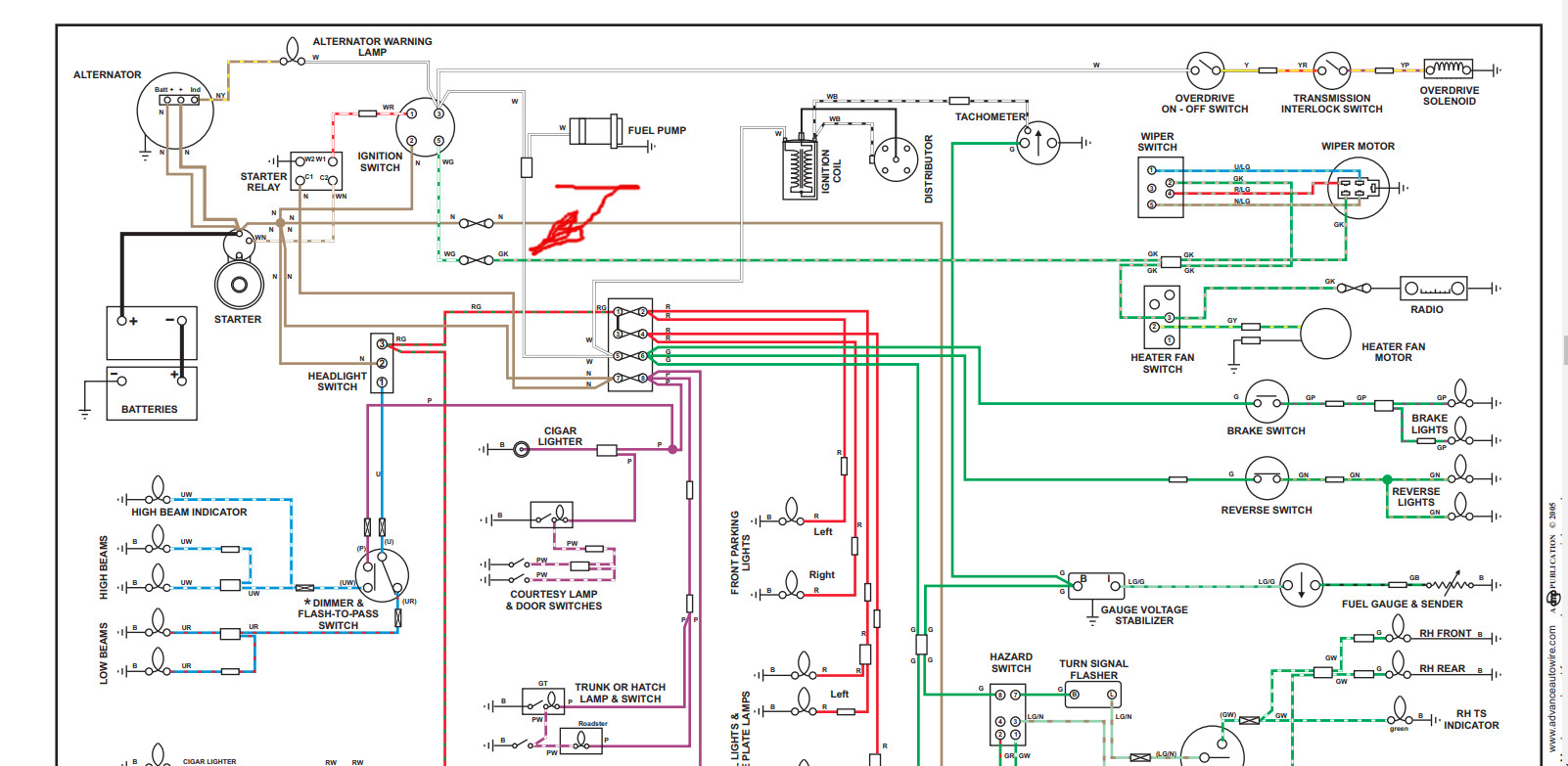

Just finished puttting a new soft top on all good so far but I as also was refitting refurbished dash vents when I lost power to
both heater switch and wiper switch , applied 12volts and both work I then checked 12 v was coming from the ignition which it was so somewhere between the cable from the ignition disappearing into the loom and reappearing at the switches I have lost voltage. It would be easy to just run a new lead and cable tie it to loom have you had this problem and what did you do ?
Regards
Chris
According to the schematic (AdvanceAutoWire site) there's an in-line fuse between the wiper/heater switches and ignition:

I found the in-line fuse with blown 17/35 amp Lucas replaced with 20 amp , the radio has been removed so it is only the wipers and heater fan operating off this circuit I believe the cause for the blown fuse was the active lead for the radio had lost its insulation tape and shorted to frame .

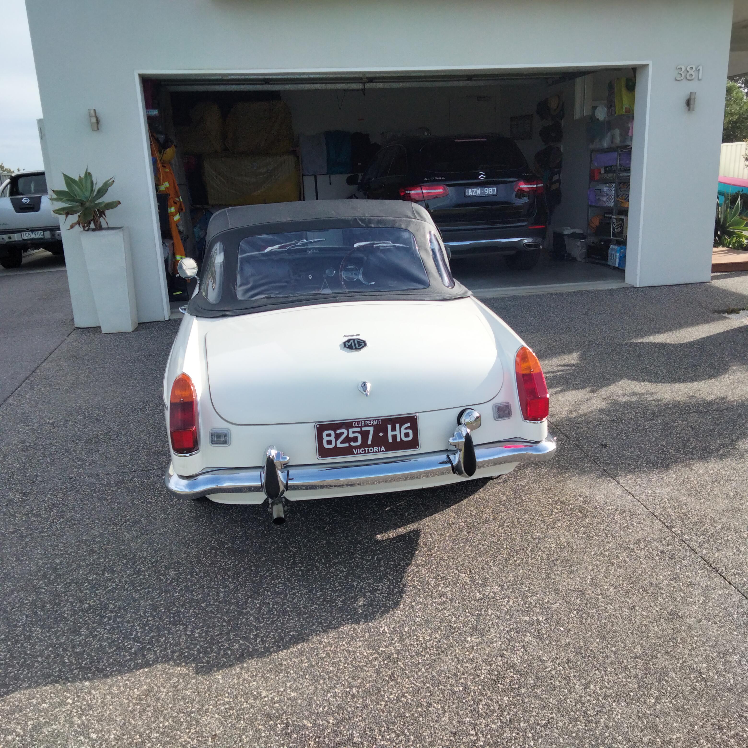

A couple of photos of the B near completion but I would like to replace the Kangol seat belts they are the type that clip onto the back deck, do you know any place that sells them for a reasonable price ?
