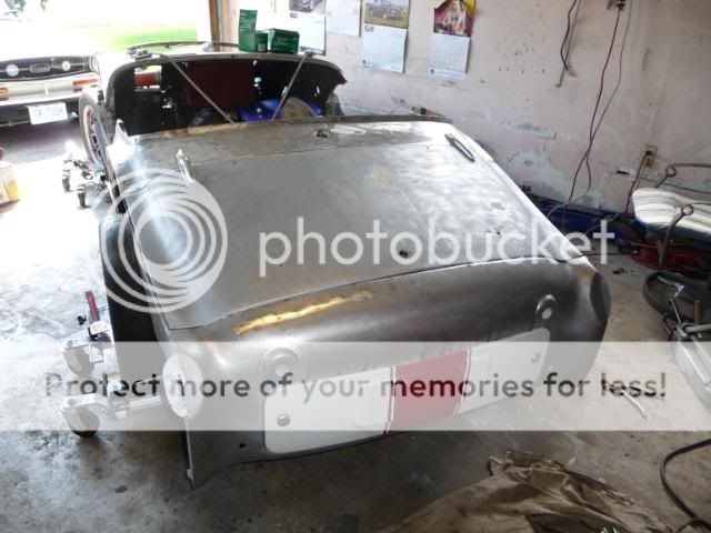

Finally welded it on. I am not too unhappy with the gaps either. A big step for me to get this done as it was becoming a bit of a mental roadblock for me. Lots of things to consider with fender fit, boot fit, spare wheel cover fit etc etc.

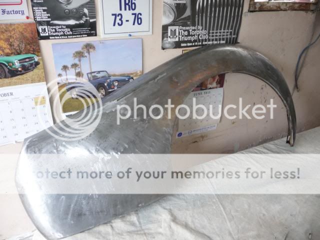

Finally got the first fender completley stripped and ready for new cage nuts on the rear. After I stripped it, I sprayed it with self etching primer to stop the surface rust.
I feel like things are moving forward again.

How did you take care of the large gap between the bottom corners of the deck lid? It looks very good now. I need to weld a little material to the bottom corner edges of my deck lid to make an even gap.

That is exactly what I had to do. I welded some material into the corners to even out the gaps. The drivers side was much worse that that passenger side.

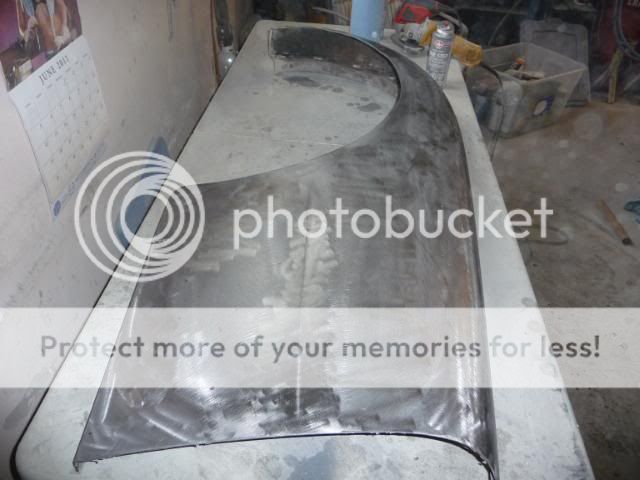

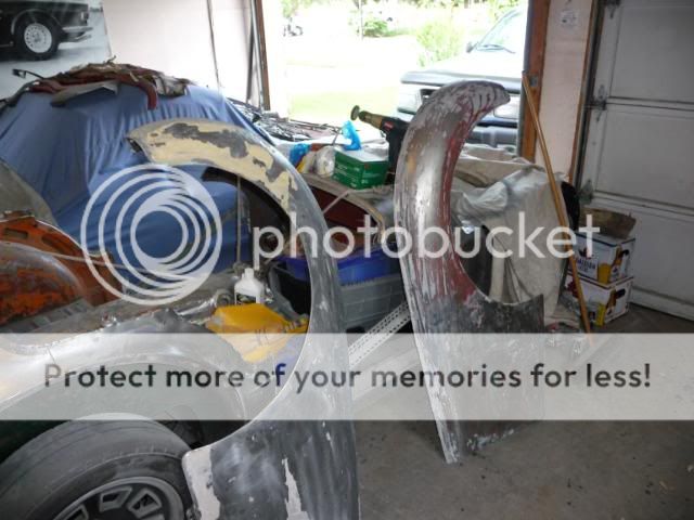

Over the last couple of days I managed to get the 4 fenders stripped down to bare metal to see what I have to work with....
The two rear wings are in pretty good shape although all the cage nuts have rusted...the centers are gone but the tabs on the sides are there....One rear wing has had a patch done back by the tail light.
The two fronts have seen some action on the race track it looks like. One is pretty beat up on the nose...you can see all the yellow bondo in one of the pics and the other is pretty rough one the bottom with some patching etc...you can see that one with the holes in it where it looks like they epoxied the panels together...the main problem is that the structure has been weakened and it likes to "oil can". What can I do to prevent the "canning"? I think that I read to heat it with a torch in the area but I am not sure.
Anyway, sprayed them with a light coat of primer for now as I didn't want them to surface rust.

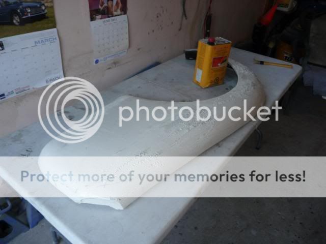

I have been using a couple of different types. First is an "aircraft stripper" that is quite expensive and comes in quite a thick brushable gel. The second about 1/2 the price of the aircraft stripper is a stripper that you would used for furniture or glue removal.
I would say that the cheap one works as well as the more expensive one. I still find myself have to use a sanding disc to get the bondo out of the fenders.
I haven't used it on the undercoating. I still use a heat gun and scraper for that or a wire brush on my grinder (makes a mess but its effective).
