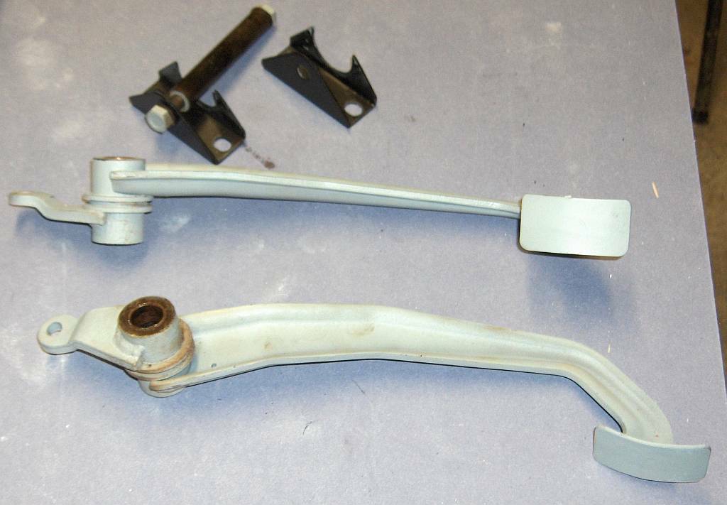

David, don't tell us you're getting lazy now. The brake/clutch pedals come apart a little farther you know. Mine probably had a little more sand/dirt inside, but after complete dis-assembly and re-greasing, they operate much smoother.
Your updates are inspiring.

Hiya Tex,
Nope not getting lazy :-)
If you notice, the pedals are not on the completed table. I am taking mine apart as well. The media blaster didn't remove some of the sealer that is applied to the back of the pedals so I am doing that by hand.
Oh, one more thing. My Holes are out of round so I will be welding and drilling prior to painting.
Will post some pics of the completed project.
That bugs me to no end - not really a design flaw or anything - just use. Just some blobs of MIG and then smoothed to shape Tush? What do you use to get the opening back to correct profile?
Hi Tom,
Yes, I think that I will weld a blob in there but try and not fully close it. I would like to be able to keep the center of the hole open a little bit if possible so I can use it as a pilot to drill a new hole.
I do have an extra pedal that I need to check to see if is any better...I might not have to do anything at all.
