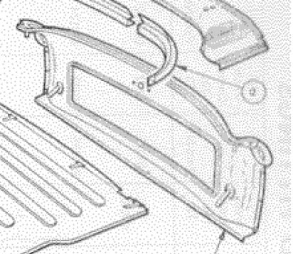

Oops! I was at least one of the guilty parties. My apologies, I misunderstood the question. I thought you were looking for the distance pieces, instead of the tubes that are part of the body.
AFAIK the body tubes are part of the rear apron assembly, not serviced separately. Shouldn't be too hard to fabricate, though.

Re: Making Progress TR3A
No Problem Randall. I will see if I can fab something up. Will see if I can find some suitable tubing at Home Depot etc. I think that the ones that are on the car are too far gone to repair.
