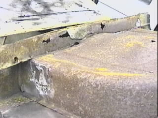

Here is what the drivers side 1/4 looked like on the inside
I then started to look at the top piece of the valence that was left. I found some rust through holes at the top inner fender where the valence side tabs attach to. To fix these holes, I was going to have to remove the tabs. I found a few other small areas of concern so I ended up removing the whole rear valence so I can fix it properly. Here is what it looks like now.

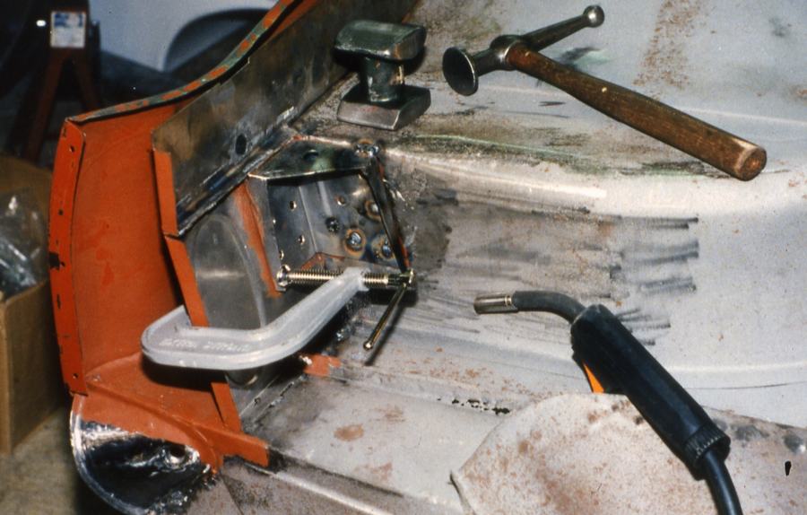

Started working on getting the rear valence back on the car. First needed to fill in the areas where I drilled out the old spot welds.
Test Fit the Rear Valence and tacked it in a few places.
Going to check the spare tire door fit and the fender fitment before I weld it in.
