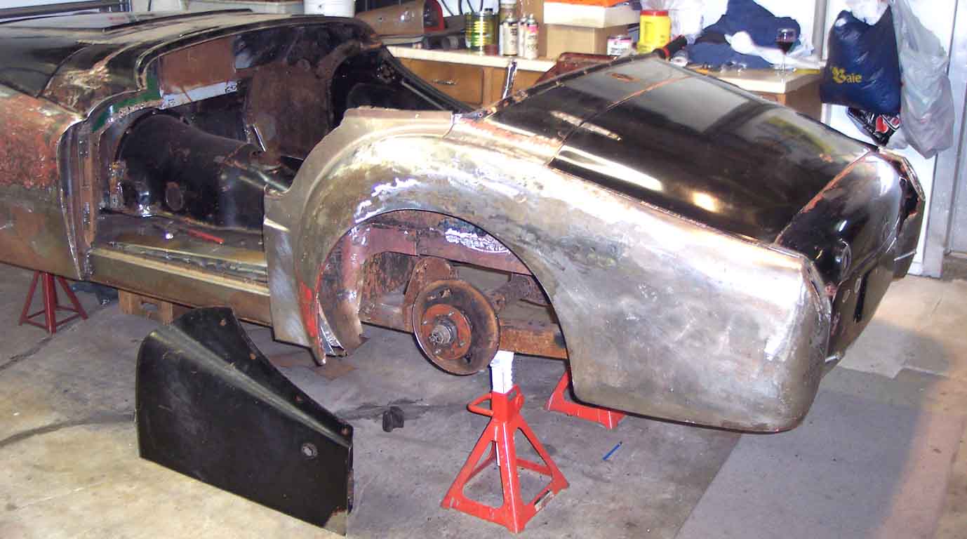

Although the holes were rather small, I had to count (and fill) them all....34 in total....I think that I am getting fairly close to getting some POR15 applied to the interior of the tub at least.
Took the body off again tonight as I think that I am going to concentrate on getting the engine fired up. I have never heard it run(wasn't running when I bought her)and I don't think that it has run in about 7 years....should be interesting! I think that I need to gather up a few of my local triumph guys for the occasion.

Looks like good solid metal your working with.
Not bad in certain areas Keith...I have seen much worse. I am still amazed at how much metal I have taken off the car and replaced though....
I think that the only welding I have to do left is the rear close out panel, battery box, left and right dogleg bottoms and a few fender plugs..I am sure more stuff will pop up though when I start playing around with the panels again.

On the late TR3A (TS 81551 L) that I restored, I had to get "new" front and rear fenders plus the LHS door because of the accident that had occured before it sat for 3 winters and summers in a garden under a tarpaulin.
The "new" rear fender looked good when I got it, but after taking out the "Bondo" along a 4 foot long scrape almost the fill length, some DPO had drlled 56 small holes about 3/16" diameter along the scrape and along each side of it. Then he had taken a tapered pin and hammered this tapered pin into every hole to flare the hole inwards so the Bondo wouldn't fall out.
I removed it all and plug welded all these holes closed with my MIG welder and then ground off the excess and sanded it flush - as it should have been done in the first place.
The fender came out perfect.
