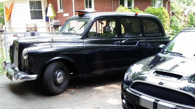

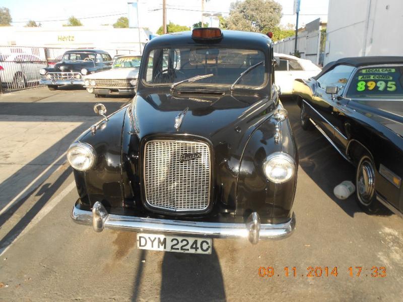

took me this long to get photos!! ha ha

We had two of the older cabs in our club, but the owner sold them. Get this! they went back to England.
Nice looking car and very different for our forum.
Jerry
That's very cool! But what are all those foreign cars in the second picture? Those are Cadillacs, which are French, right? ;)

Only looking at the exterior, it looks like a very nice example. Is it a diesel or gas? I wouldn't change a thing on it, leave it as original, it will carry a higher dollar value if you do. No radios or odd ball trinkets should be put in it and even keep the original upholstery if possible. It's hard for some folks to remember that they were a working machine, not a personal driver. They don't look right in any other format. JMHO. PJ

Planning on keeping it is original as possible. It is a diesel, so a little hard to start in the cooler weather, but once it's going it ticks (or is that "rattles") along forever.
We took it on the Woodward Dreamcruise a couple of weekends ago and it got a ton of interest, even though we were surrounded by muscle cars, supercars and wierd and wonderful examples of engineering.
