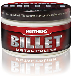

To find out if it's chrome or aluminum, rub some polish on it. I like Mothers Billet metal polish. If the rag turns black, it's aluminum. If the rag does not turn black, then the aluminum may have a clear seal product on it, or its chrome.
If it's non coated aluminum, then you can wet sand the scratches with 2000, then polish to a shine with Mothers polish.

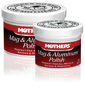

Make sure you buy the Bullet metal polish, NOT the Mag & aluminum polish, photo below for reference.
The Bullet works much faster and better. (almost twice the price for the same amount...of course.)

Coastalman
Good follow up info! I have seen the little tubs like the picture before and might just have bought that.
Thanks,
Charlie
I tried the Billet and to my surprise, the wheel looks like new. I have had this stuff for a while and never used it on the car. I have a large collection of antique slot machines and that stuff sat in the service area. Thanks, Roger. What a tip!
