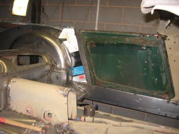

I am about to set out my BJ7 hood frame so that I can weld the hood mounting brackets in the right place on the wheel arch. I have the hood frame,wooden header rail, hood clamps, header rail seal and the header rail retainer but am not sure in which order they should go.
My intention was to use the hood clamps to clamp the hood frame to the windshield and then work backwards to the mounting brackets which I assumed would become clear where they go as the frame would be fully open ?
As I have no measurements and these are new wheel arches I don't see any other way.
I figure the wooden header is screwed to the hood frame but that's about as much as I can figure out.

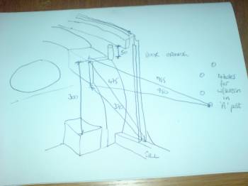

I replaced mine using a cardboard template from the original positions, trial fitted the hood frame with the brackets only tacked.
Theres also a pic of measurements taken. I'm still messing around with the window gap to cant rail fit (car originally had one packer piece). Just need to get the motivation to realign screen / quarterlights and door glass to give better fit.

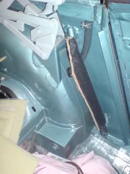

Thanks for the pictures, any chance you could email me a copy of the drawing with the measurements on, I can't read it at that size ?
What is the box section below the mounting bracket in the footwell ? is this some strengthening piece or just relevant to the BJ8's
I tacked the brackets in place where I thought they should go and all seemed ok although I have not fitted the door glass yet. From my understanding as long as the gaps are ok round the window glass then as I am getting a hood made to fit it shouldn't be an issue.
Those boxes are for the radius arms on a BJ8.
