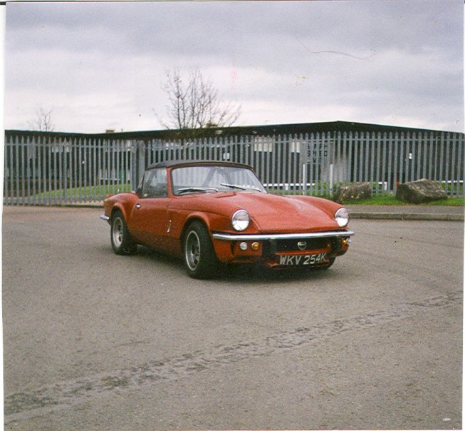

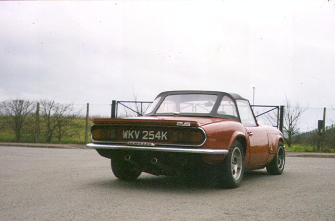

I did a 1976 Spit-6 2.5 a few years ago,center of hood section from a 69 GT6,good parts triple manifold,GT6o/d trans,beefed up engine,KYB shocks,yokos/turbine alloys,supersprint exh,moto lita wheel,new int etc,etc. It came out nice,if some one will show me how to post pix, I would be glad to.
