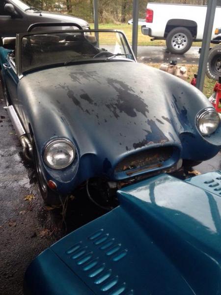

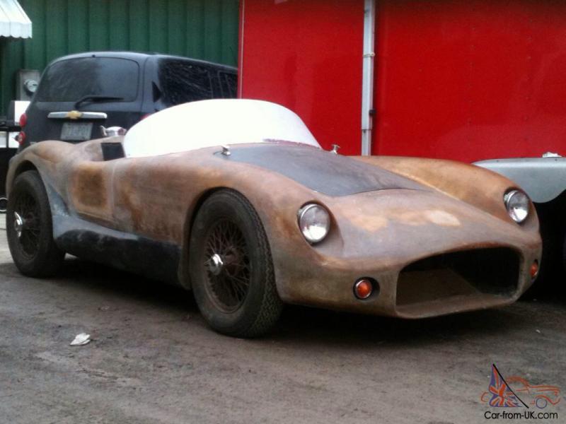

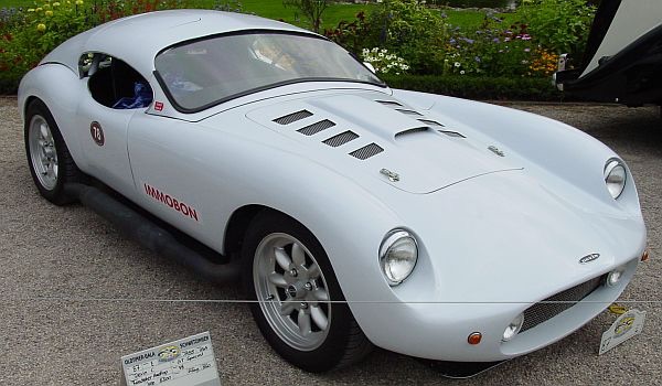

i love the lines of the Devin car plus it looks a lot like a Thomas dinner front end I've got lying around for a sprite project. Wonder what the easiest way would be to round and change the front end a little bit? Attached a few ideas, first is my Thomas denner hood for a sprite, second 2 are from searching the web. Not saying I'd chop up a rare hood, just ideas on design to make the front end look a little bit better.
