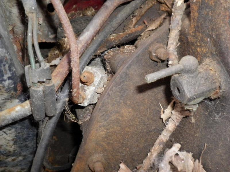

I'm confused; why would you need a remote bleeder on a GT6? The slave cylinder is pretty much right there, accessible from the engine compartment. Granted, this photo is from a car with no manifolds in the way. Still....

Andy, you are right... I can see the bleed nipple but getting in there with a hose and wrench is really a little easier said than done.
