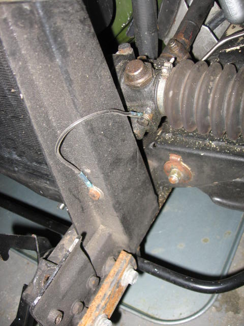

Here's a picture of how it was done on a friend's Bugeye and how i plan to do it on my Bugeye.
Putting a wire on the (rotating) steering shaft doesn't sound like a permanent way to do it.IMG_8912.JPG
