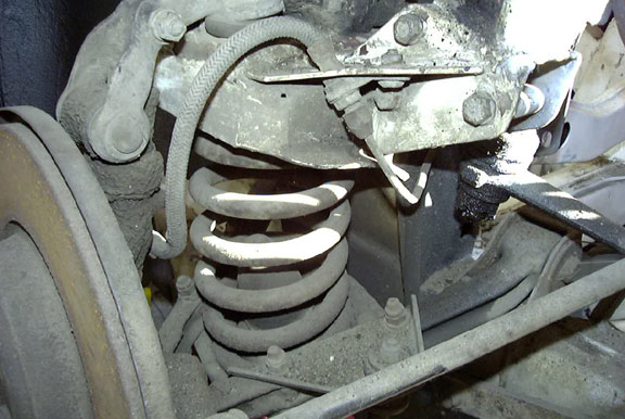

Hi Shorn,
Here’s a photo of how my brake hose was routed for comparison. I have a spare set of new hoses I can measure for you. ( I saw them when I was looking for the convertible top shims)
S
shorn
Greg,
Thanks, that helps. Yours are obviously shorter. Yours bend almost immediately at the bracket. Mine seems to rise 2-3 inches before bending and are thus rubbing against the shock arm. Guess I better get some new shorter hoses.

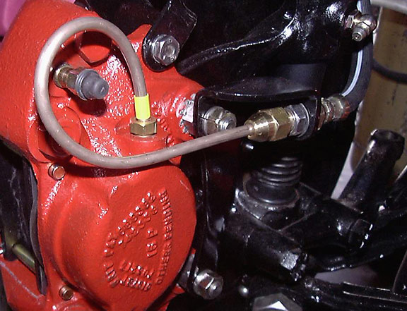

Hi Shorn,
Another thought, is the hose attached to this bracket?
Keoke
Hi Shorn, Yes the tubing attached to the bracket shown by Greg can be distorted contributing to your problem. New brake hoses from moss and I suspect from others also are shorter than the originals. Consequently, to protect them I go to a Jaguar dealer and get their coiled abrasion protectors and fit them over the brake line. They are made using a very abrasion resistant plastic type material that is formed into a springs shape. Very easy to thread over the brake line In situ.---Fwiw---Keoke
