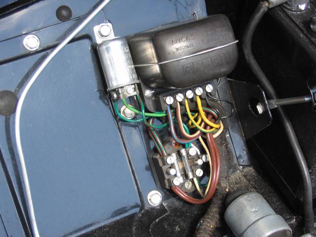

As George pointed out above, if the Comm. No. (VIN) is correct, there should be a panel just a bit to the right of the VIN plate like mine has (TS 27489 LO). I suggest that the car is much later - maybe around TS 43000 L and someone has put this VIN plate on it which is incorrect. I also suggest that the engine may be the original one.
