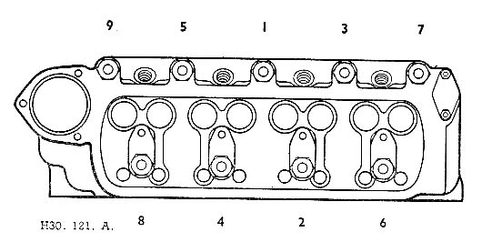

Sarastro
I hope you're aware that they should be torqued in a certain order, and that you should bring them up to the specified torque gradually. The Bugeye manual says one turn at a time.
Sorry if I'm insulting your intelligence, but a lot of people don't know this, and apparently you don't have a manual to show you the process. The figure below is from the Bugeye manual, but it should be the same for all A series engines.
